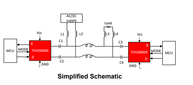

    I will note that in general the THVD8000 is used to communicate on a shared bus  - so between nodes it can be two wire - but at the coupling network there are 4 wires still.
    So the communication isn't directly on the power line - but the power and data are combined into one bus. The reason I am being pretty specific on that is because there are applications were you inject data onto the actual power bus (no inductors as shown as above) - but that type of application is generally much more complex and if you can avoid it I would.
    That being said:
    The simplest solution is connecting to the 24V DC bus - so the DC supply in the above figure would be 24V. You should be able to support 30 nodes in this application without much issue. The datasheet basically gives all the guidance you need to finish the 24V DC bus - I have also added the design guide and an excel calculator to size the capacitors and inductors of the coupling network.

    One stupid question is: whouc could the "load" be in your picture?

    The load is any device that consumes power. In your application, that would probably be the power supplies of all nodes.

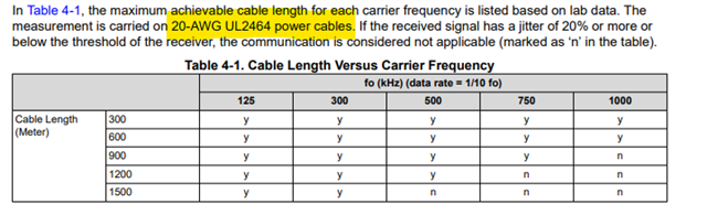

    If you look at our THVD8000 Design guide we do have a chart of max distances with a specific wire (20 AWG UL2464 power cables - which is not impedance controlled cable)
    As stated in above table a 'y' indicates that data reception occurs with up to 20% jitter - if it goes above 20% jitter it will be marked with "n". In general the jitter will be lower if you are not maxing out distance vs. modulation frequency.

    As for the "load" - it really can be anything but in general it usually is a SMPS or LDO with bulk input capacitance for DC systems and rectifiers for AC systems - but it doesn't necessarily have to be. In general the standard implementation the THVD8000 wants to see "AC GND" past the inductors - so as far as the THVD8000 is concerned the power load and power source might as well be AC ground - and usually with the assumed bulk capacitance included for the power supplies it basically is "GND" to the THVD8000 while it isn't "GND" for the power signal.
