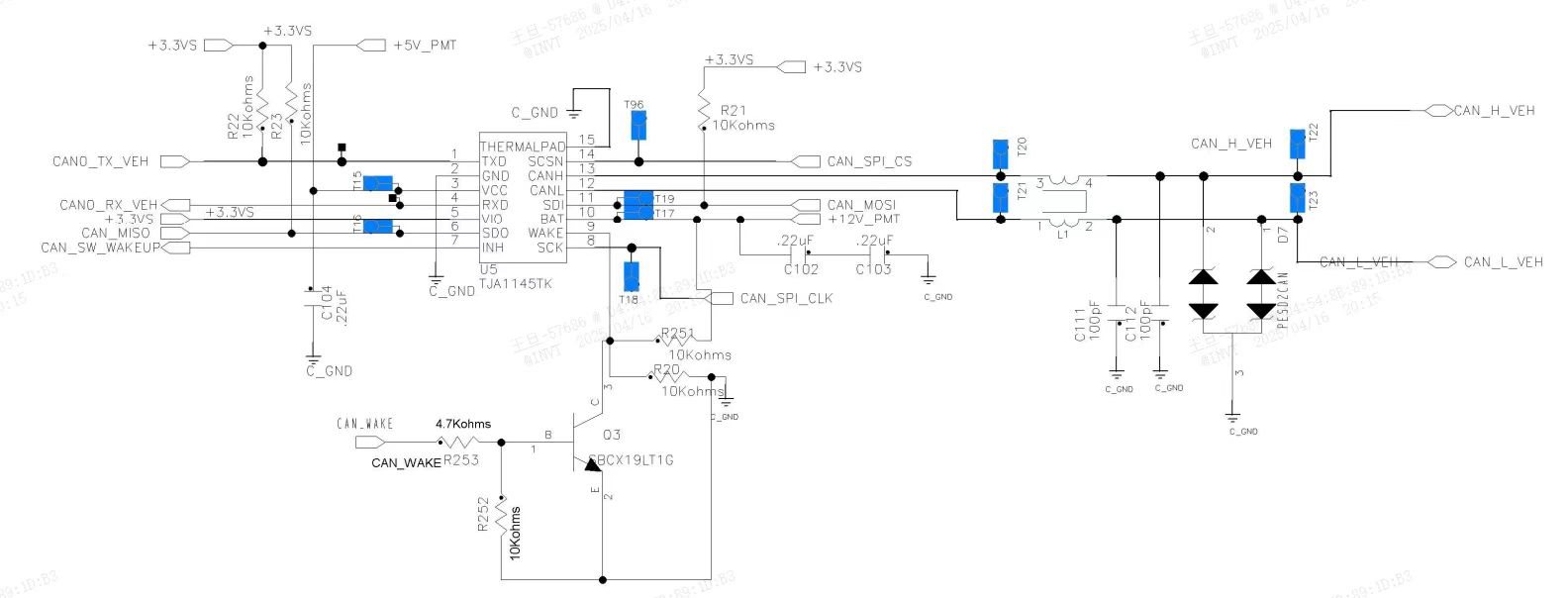

My customer uses TCAN1145 in PDU products and met below three questions:
Q1: When TCAN1145 go into sleep mode and it will be waked up due to the accumulated number of error frames.
       How can they avoid it. All they need are WUF(special ID) wake up?Is it useful to set FRAME_OVF_ENABLE to 0? Customer tried it before going into sleep mode. But it doesn't work
Q2: Register 56h can not be setted up when TCAN1145 is in normal working mode.
       Customer tried to set 56h to from default 0xff to 0x40 in 10ms. But it will be 0x40 after the customer's operation but soon will automatically be setted to 0xff during 10ms period. Customer need to set it again but it will aslo back to 0xff again.
Q3: Customer uses CAN fault generator to artificially make CAN frame fault. But when customer reads the register of 45h(FRAME_CNTx), it will not add 1 after they make one time CAN frame fault. Why?

  • Hi Eric,
    Thanks for your help.
    Customer follows your two suggestions about Q1. It will not be waked up anymore when it is in sleep mode unless there is a WUF. Is it meanning that wake-up event is casued by CAN-FD frame.Customer said CAN format they uses should be standard CAN rather than CAN-FD. data bit is 8.
    Could you please help review the software codes. document 1 is about POR Initialize and document 2 is for going into sleep mode.
    TCAN1145 POR initialize.docx
    TCAN1145 go into sleep mode.docx
    For Q2, they can successfully change the registers now.
  • Problems encountered at present
    • Errors in error frames will not make the error accumulation register +1, at 500kbps, regardless of whether CAN-FD is shielded
    • Not sure whether the frame currently sent is standard CAN or CAN-FD
    • After using the CAN-FD shielding function
    ○ Non-ID specific frames at a communication rate of 500kbps will not wake up the sleep state
    ○ 500kbps ID specific frames will wake up the sleep state
    ○ 250kbps specific frame ID will not wake up the sleep state
    ○ But non-specific frames at 250k will wake up the sleep state. Could it be that this 250k is a standard CAN frame, and the CAD-FD shield cannot shield it
