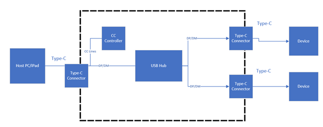

Dear Texas Instruments Support,
I am working on a project where I need to configure the TUSB320LAI (USB Type-C Configuration Channel Logic and Port Control) using a PIC16F1508 microcontroller over I2C using protocol.
I am using this IC with following PIN configuration from Hardware side,
- PORT - NC – DRP mode
- ADDR – Pullup - I2C is enabled and I2C 7-bit address is 0x67
- As per our schematic, we connect host to J7 Type-C pin connector, another J6 & J8 Type-C pin connector working as device
Our core requirement is:
“To enable simultaneous charging and data transfer through the same USB Type-C port (host side).”
One of my team members from the hardware team reached out to TI Support regarding the selection and configuration of the TUSB320 IC about four months ago. Please refer to the following link,
https://e2e.ti.com/support/interface-group/interface/f/interface-forum/1475854/tusb321-validating-concept-of-host-charging-using-configuration-channel-logic-and-port-control-with-vcon
According to ‘Vishesh sir’ response, "the TUSB320 IC can charge a device while supporting USB data transfer to and from the USB host without the need for a PD controller."
However, based on my recently discussions with TI Support engineer ‘Ryan Sir’ and our experimental results, it appears that the TUSB320 IC does not play a role in USB data transfer. Please refer to the following link,
https://e2e.ti.com/support/interface-group/interface/f/interface-forum/1532631/tusb320lai-tusb320lai-csr-register-configuration-by-i2c-protocol
We would greatly appreciate any suggestions on:
- Whether any hardware modifications are needed (e.g., adding an additional IC)?
- Any specific configuration required for the TUSB320?
- Whether another IC such as a PD controller or DRD-capable IC is necessary to fulfil our use case?
- Kindly suggest another IC (Similar with TUSB320) which have 1 Amp Current mode.
Please advise on a proper solution for achieving our requirement.
We are preparing to submit the prototype to our customer next week, so we kindly request your urgent support in resolving this issue. Your guidance is crucial at this stage.
Here is attachment of my code and our schematic of TUSB320LAI IC. Please find it.
