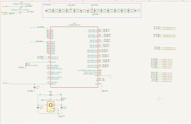

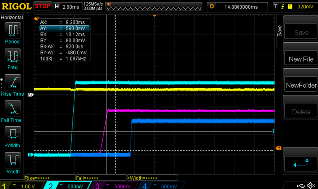

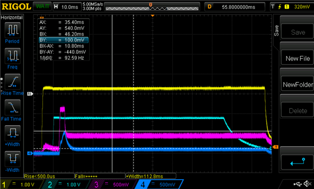

Hi all, I'm trying to chase down why we are observing an issue where if a TUSB8020B is being supplied from a TPS6522053, we are having some issues with the power on sequence. Removing FB41 allows the TPS6522053 to complete the power up sequence, and bring up the processor.
Prior to removing FB41 (2nd shot, CH4 is 0V85, possible reverse voltage):
After removing FB41 (CH4 is 0V85):
Is there an idea of what is possibly happening here?
