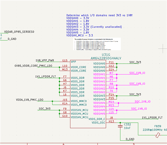

AM6442: Schematic review request - TPS6522053 unable to fully ramp up BUCK2/BUCK3 outputs (1V8, 1V1)
Part Number: AM6442
Other Parts Discussed in Thread: TUSB8020B
Hi all - I have a schematic review request for a design with a AM64X processor. Right now we're seeing the TPS6522053 unable to fully ramp up, and we're hoping that we can get some insights as to what might possibly be going on.

  • Hi Sreenivasa - it looks like I'm getting an unexpected voltage coming from the AM6442, out of the IO supply (the thread is over here  TPS65220: TPS6522053RHBR Failed to generate power supply rails )
    Doing a cursory check, it does look like I have a failure where I tied a an IO supply to the incorrect supply rail - I expected VDDSHV4 to be tied to 3V3, but it is instead supplied from the 1V8 rail.
    That said - we aren't at the point where the PMIC supplies 3V3 to the AM6442 yet - so yep, a bit weird.

    The pullup voltage referenced to any of the IO is expected to match the IO supply for IO group (VDDSHVx)

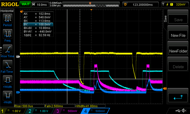

  • So the PMIC does start - it tries three times (we go through it in the other thread with oscope shots and everything :D) and then stops.
    Doing some more probing at various points just now - the PMIC does (briefly) turn on the enable for the 3V3 switch, providing the AM64 (along with all of other consumers and pullups) with 3V3 power in those pulses.
    My best guess would be that the pullups on the IOs associated with VDDSHV4 (tied to 3V3) are pulling up the SOC_1V8_IO rail. This should be testable if I remove pullups for I/Os associated VDDSHV4 (or perhaps just cut the traces for the I/Os, since with the wrong sourced voltage it isn't really going to be any help) - I would then expect the voltage to no longer be present on the SOC_1V8_IO rail. Does that seem reasonable?

  • Hello James,
    Which IOs are you seeing that is connected to 3.3V  for VDDSHV4?
    Sreenivasa

  • Ugh - so the PHYs (DP83822IRHBR - U40, U41, U63) are operating off of 3V3, with 3V3 I/O - which means that quite a bit of VDDSHV1 and all of VDDSHV2 would be impacted.
    For the sake of trying to just get the processor up and running on the board as of now, I'm connecting all of the VDDSHVX to 3V3, and then removing resistors that would pull up to 1V8 or otherwise connect to 1V8 devices (e.g. the WLAN SDIO line 0R and pullups)
    VDDSHV0 - 3V3
    VDDSHV1 - 3V3
    VDDSHV2 - 3V3
    VDDSHV3 - 3V3
    VDDSHV4 - 3V3
    VDDSHV5 - 3V3
    (eventually, this will be reworked so that SHV0-4 are 3V3, and SHV5 is 1V8 towards the WIFI). I've removed the FB42, and connected the INT_3V3 so that all of the SOC_1V8 is now 3V3.
    In combination, this looks to remove (most of? all of?) the backpowering - the rails from the PMIC are able to come up to their specified voltage, but the 1V1 sags shortly after it reaches 1V1 (about 2ms after reaching 1V1) - see oscope shots below.
    The 1V1 is connected to the AM64X, LPDDR4, and a 2-port USB hub (TUSB8020BIPHP - U34) -  honestly I wouldn't expect this to hit current limiting, but unsure if that is what is going on or not.
    On a side note- the timing before the 1V1 sags is remarkably consistent (2.160ms).
    Any thoughts on where to possibly go next?

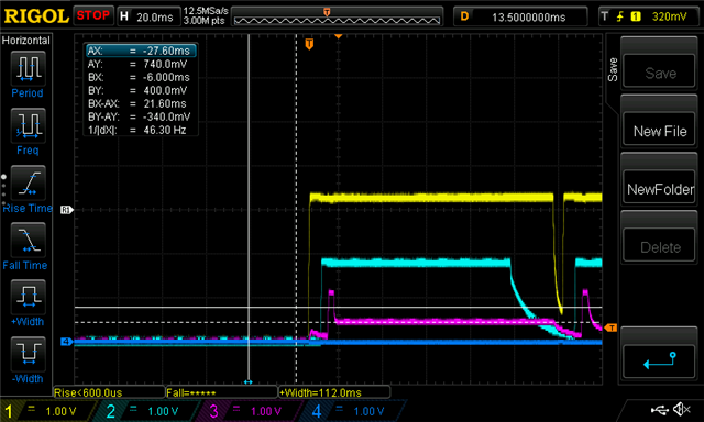

  • Hello James,
    Thank you for updating the progress.
    Can you please confirm the MCU_PORz input (SOC cold reset input) is low while the supplies ramp,
    Can you please measure the 1.1V after it sags?
    Is the SAG present until the next power cycle or does it recover?
    Sreenivasa
  • Hi Sreenivasa - the drop is to 400mV - and it recovers for the beginning of the next cycle (ramp to 1V1, 2.160ms start to curve down to 400mV).

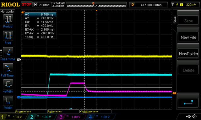

  • The MCU_PORz is held low for the entire time (CH4).
  • Both a whole board power cycle, and the PMIC power-up attempts (right now, it is attempting three times to bring the rails up - the  dip in CH1 is the INT_3V3 dropping and coming back up due to the IO from the PMIC turning the supply off and back on).

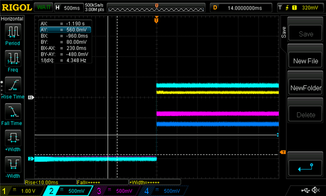

  • I've pulled the register information for the PMIC - it looks like it has an issue with LDO2 (0V85). I'm going to try real quick to see how the 0V85 looks like, particularly in comparison to the 1V1. I don't see anything in particular that alarms me about the 0V85 in terms of what it connects to, so that will be interesting to see.
    If that doesn't prove any particular illumination/insight, I'll pull the FB41 and see if that provokes some changes.
  • So the 0V85 (LDO2) looks like it is having some issues ramping up - it gets to a max of ~560mV, then drops to ~80mV - the timing coincides with the 1V1 drop as well.
    The LDO2 should be fed from the 1V8, which doesn't show any particular signs of trouble. There's an interesting hitch present in the restart for the 0V85 on the 2nd attempt (and it doesn't reach the same max), but 1st and 3rd are pretty close.
    Note - changed the vertical scale for CH3 CH4 in the scope shots.
    The 0V85 is only connected to the AM64X, and should have 17.84uF of capacitors attached to it counting those at the output and at the load points.
    I could pull FB41 just to see what is going on, but I would definitely not expect it to be impacting the 0V85 line.

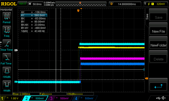

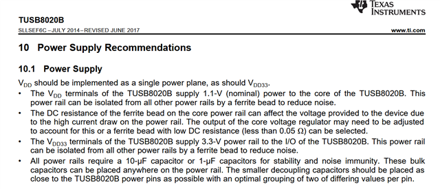

  • Removing the FB41 looks to resolve the 1V1 and 0V85 slump!
    Now the question is - why?
    Looking further into the datasheet:
    So these criteria should be met for U34 - and we weren't getting current limiting warnings from the PMIC.
