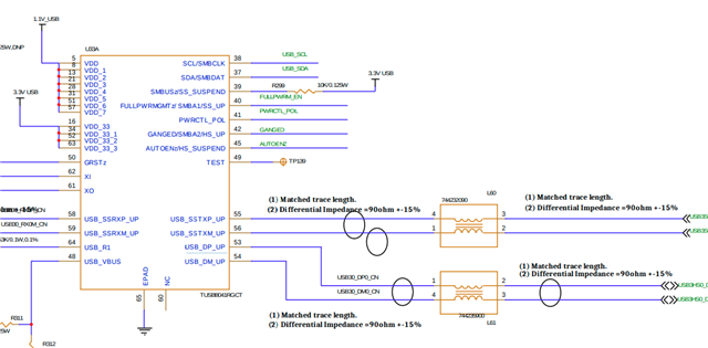

We’re working on a custom board running Yocto Linux and using a TI TUSB8041RGCT USB 3.0 hub. USB devices connected through the hub are not being detected/enumerated.
I’ve attached our current Device Tree configuration and the relevant dmesg/USB logs. Could you please review and confirm whether any required Device Tree settings are missing or misconfigured?

  • HI Shaik:
       I didn't see TUSB8041 form your log, TUSB8041 VID is 0451.
       What voltage on USB_VBuS pin? it should be around 500mV.
    Best
    Brian

  • HI Shaik:
       GRSTz should keep low at least 3ms after 3.3v and 1.1v are stable. can you delay GRSTz signal ?
    also use lsusb -tv to do test?
    Brian

  • I can not see TI hub detected in your system.
    Is there EEPROM installed ?  the EEPROM was programmed or empty?
    Can you take waveform for 1.1v /3.3v/GSRTz?
    Best
    Brian
  • We have an AT24C04D-SSHM-B EEPROM where pins 38 and 37 from usb hub are connected to this eeprom , and pin 39 is connected to 3.3V.
    How can I verify whether the EEPROM contains programmed data or is empty?
  • If EEPROM was not programed before installed on PCB, then it should be empty.
    Just remove pullup on SCL/SDA and test again.
    Brian

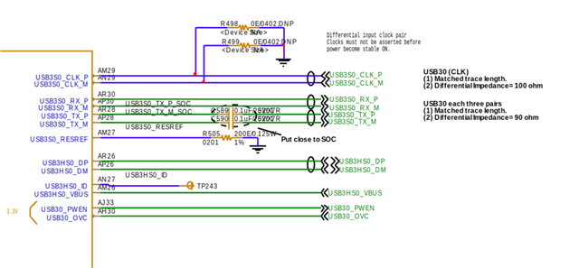

  • Hi Brian,
    1. We would like to confirm the following connection between the SoC and the USB hub:
    SoC ------------> USB Hub
    TX+ ------------> TX+
    TX- ------------> TX-
    RX+ ------------> RX+
    RX- ------------> RX-
    DP ------------> DP
    DM ------------> DM
    Is this connection correct?
    2. We would also like to confirm the reset sequence for the USB hub.
    For resetting the hub, is it necessary to pull the power rails (1.1 V and 3.3 V) low and then bring them back high before releasing the reset, ensuring that reset is asserted high only after all other lines are stable?
    Or alternatively, can we perform the reset in the following way:
    1. Ensure 1.1 V and 3.3 V power rails are already up and stable.
    2. The RESET pin is currently high.
    3. Pull the RESET pin low for more than 3 ms.
    4. Drive the RESET pin high again.
    Will this sequence successfully reset the hub?
    3. In our current sequence, the 1.1 V rail becomes stable first, followed by the 3.3 V rail. Since the RESET pin is pulled up to 3.3 V, it goes high by default when 3.3 V is applied.
    After approximately 20 seconds, we pull the RESET pin low for more than 3 seconds and then drive it high again.
    We would like to confirm whether this reset sequence is valid for properly resetting the hub.
    4. Also What should be the status for below usb hub pins:-
    39,40,41,42,45
    Adnan
  • 1. We would like to confirm the following connection between the SoC and the USB hub:
    DP ------------> DP
    DM ------------> DM
    it should be:
    TX+ ------------> RX+
    TX- ------------> RX-
    RX+ ------------> TX+
    RX- ------------> TX-
    DP ------------> DP
    DM ------------> DM
  • For resetting the hub, is it necessary to pull the power rails (1.1 V and 3.3 V) low and then bring them back high before releasing the reset, ensuring that reset is asserted high only after all other lines are stable?
    both should work.
  • Also What should be the status for below usb hub pins:-
    39,40,41,42,45
    pin 39 should high for i2C mode, other pins can be either high or low.
    what status for pin 49 (TEST) , it should be low.
    Best
    brian
  • Hi Brian,
    Thank you for your input.
    Based on this, it appears that our SoC to Hub TX and RX connections are incorrect on our Custom board.
    For quick validation, can we disconnect the TX and RX SuperSpeed signals and connect only the DP and DM lines of the hub to the SoC to verify the hub functionality?
  • Currently, we have removed the EEPROM and the pull-up resistors on the SCL and SDA pins. Since we are not using I²C/SMBus at the moment, should pin 39 be left NC (Not Connected), or should it be pulled High even though the I²C/SMBus interface is not being used?
  • Based on this, it appears that our SoC to Hub TX and RX connections are incorrect on our Custom board.
    you can disconnect TX and RX and USB2 should work.

  • This is correct connection, are there 100nf caps between SOC and  USB hub?
    DP ------------> DP
    DM ------------> DM
    Best
    Brian
  • Hi Brian,
    on which lines should 100nf be present ?
    Below are our soc to hub tx,rx and dp dm lines
  • so from hub to SOC, 100nf is need on SSTX_UP of hub. which is connected to SOC SSRX
    Best
    brian
  • Okay will see what can be done regarding the 100nf on SSRX_UP going to soc
    When we disconnected SSTX_UP and SSRX_UP from the SoC and kept only DP and DM connected, the upstream port was still not detected and the same error -71 continued to appear.
    However, when we disconnected the DP and DM lines from the SoC and instead connected them to a USB cable attached to a PC, the upstream port was detected on the PC, but the downstream ports were not detected.
    Is there any specific reason why this behavior might occur?
  • However, when we disconnected the DP and DM lines from the SoC and instead connected them to a USB cable attached to a PC, the upstream port was detected on the PC, but the downstream ports were not detected.
    do you have Vbus for downstream port ?
    Best
    Brian
  • yes downstream vbus is connected to 5V
  • did you try to USB HS device on downstream port instead of mouse or keyboard ?
    Best
    brian
  • Hi Brian,
    We have not yet tested with other devices.
    Currently, the upstream enumeration itself is failing. Could you confirm whether upstream enumeration requires any devices to be connected on the downstream ports?
    In our design, out of the 4 hub ports:
    • 2 ports are connected to USB Type-A connectors
    • 2 ports are connected to USB-to-LAN interfaces
    I’ve attached the schematics for your review. Apart from the earlier TX/RX swap issue (which has now been corrected in hardware), please let us know if anything else might be missing or incorrect.
    7536.usb-hub.pdf
    Adnan
  • Hub upstream enumeration don't need any device connected to downstream port.
    what is voltage on USB_VBus (pin48)? it should be > 400mv .
    Can you take waveform on upstream DP/DM during hub power on
     Best
    Brian
