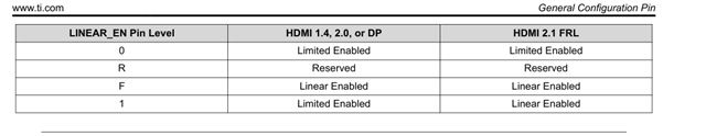

    If this is a sink side design, then I would have LINEAR_EN pin to be floating to enable TMDS1204 into the linear mode.
    You can then turn the EQ0/EQ1 to see if there is an output on the monitor.

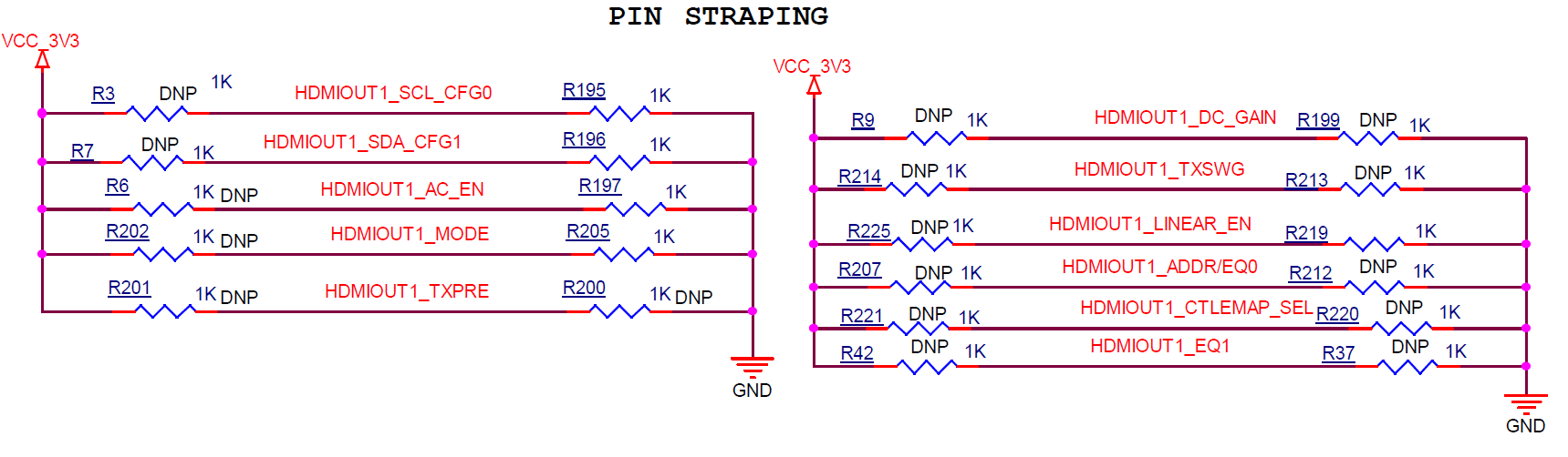

  • Irfan
    With Mode pin pulled up, TMDS1204 is in pin-strap mode with flexible receiver equalizer with no fan-out buffer support. Is this a source or a sink side design? If it is a source side design, then I would recommend to use fixed equalizer and EQ0/1 need to be tuned depends on the pre-channel insertion loss.
    Can you please share the schematic for review?
    David
  • Hi David,
    Kindly find the attached schematics for your reference.
    Also, can you share any reference where HDMI 2.1 pin strap setting is implemented based on the requirement of HDMI 2.1.

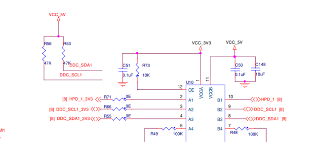

    Looking at the schematic, how are you implementing the DDC bus? The TMDS1204 has integrated pullups to VIO on the DDC LV pins. Therefore, no external pull-ups shall be present between the TMDS1204's DDC LV pins.

  • David,
    I have tested it removing the DDC PU which i have given externally.
    how does this effect HDMI 2.1 operation?

    The PU on DDC will impact both TMDS and FRL. There is internal pulldown on the LV_DDC and the LV side pulldown is not enabled unless the LV voltage goes below VILC. If having external pullup, then you are preventing the LV side pulldown ever gets enabled.

    There is no effect of removing the PU's on DDC lines, the output is still the same(No output)

    The pin strap settings are proper in schematics?
    Also for HDMI2.1 FRL  TX the AC_EN pin should be low or High.

  • Irfan
    In I2C mode, you can read TMDS1204 register 0x20 and 0x31. Below is how FRL and TMDS are being determined.
    If the TMDS1204 TX output is DC coupled, then AC_EN needs to be pulled to ground. If the TMDS1204 TX output is AC coupled, then AC_EN needs to be pulled up.

    If Linear EN pin if Pulled up then it will be linear enabled for FRL and Limited enabled for TMDS,

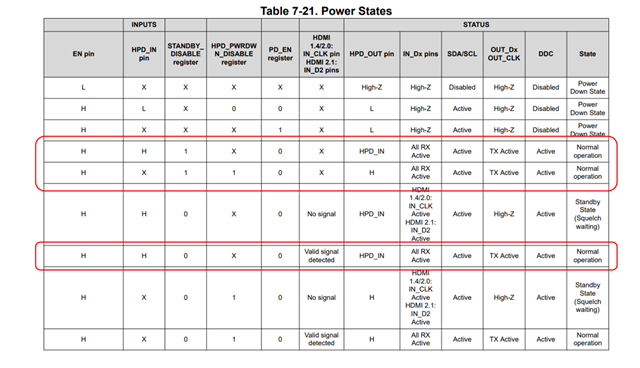

    If you are not seeing the output, then tuning the EQ will not help. We need to understand why there is no output.
    Below are the TMDS1204 power conditions, I highlighted the normal conditions, are we meeting these conditions?
    Is it possible to put TMDS1204 into I2C mode and debug this issue using I2C registers?

    The power conditions are met. We are able to see TMDS output but not FRL.

    Irfan
  • Irfan
    It looks like the ESD in the design has a line capacitance of 0.35pF, this is too much capacitance that will degrade the signal quality. If you look at its datasheet, you can see it only presented eye diagram at HDMI1.4 3.4Gbps, it does not provide any data for HDMI2.0 or HDMI2.1. I would recommend to use an ESD with lower line capacitance.
    Since this is a TX side, the pullup resistors on DDC is 2k, 47k is for the sink side.
    Right now, I think we need to look at these two things:
    1. DDC bus communication, The FPGA log file on the TX shows the link training is passing at 8Gbps, but the signal integrity may be bad that once the video starts, the monitor has a hard time to lock onto it. For DDC bus communication probing, you can use a Saleae I2C analyzer.
    2. The FRL signal quality, you will need a high BW scope to measure its signal quality.
    David
