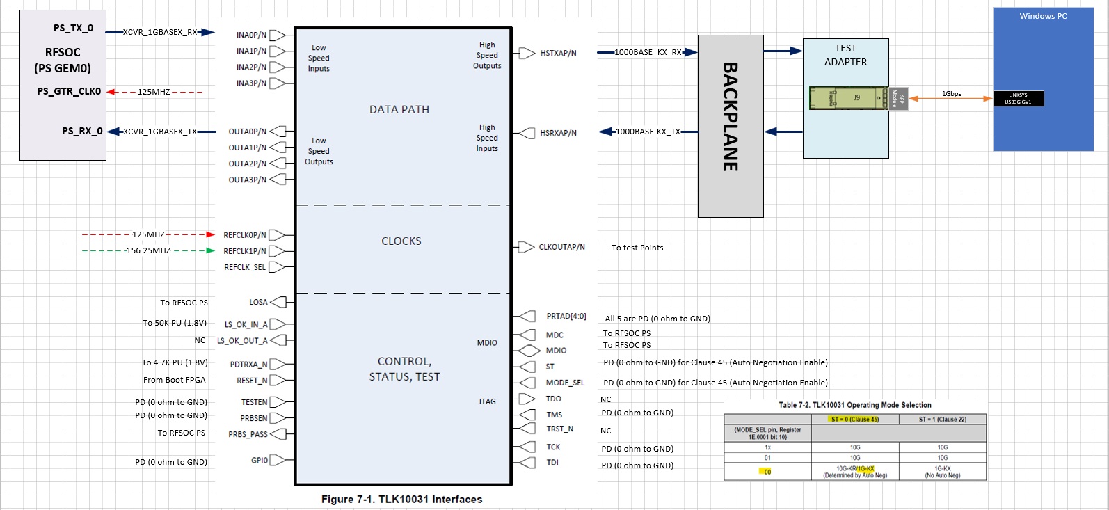

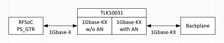

I need help configuring the TLK10031 registers for my implementation (see attached pictures). I also need to know which registers do I need to read to verify that the TLK10031 is being initialized/configured correctly.

Hi Alonso,
Please review the bring up procedure attached in the thread below.
