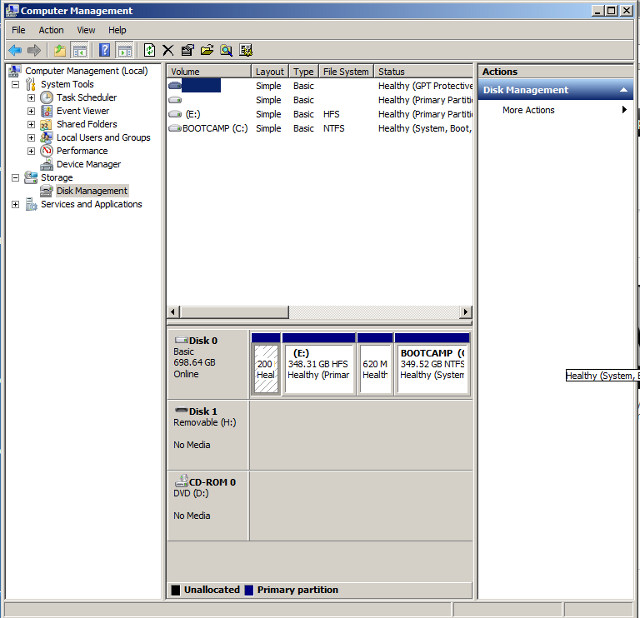

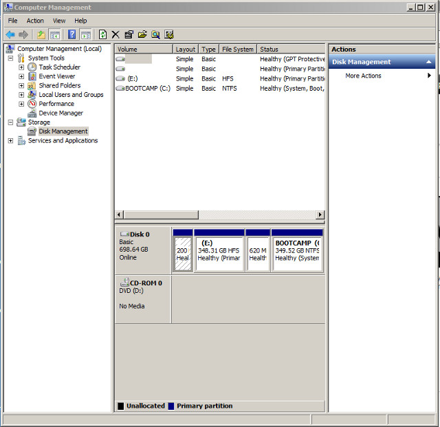

Without an eSATAp drive connected, both Windows 7 and Linux PC's can see the TUSB9261. In the case of the Win PC, "Computer Management" showed it as Disk 1, Removable (H:) No Media
However, when media IS inserted, neither the Win or Linux PC's can see the TUSB9261 any more. In the case of the Win 7 PC:
Regardless of whether the HDD is connected or not, the HDD_ACT led is ON, as is the SS_CONNECT led. While theSW_HB lead is pulsing at ~ 1Hz

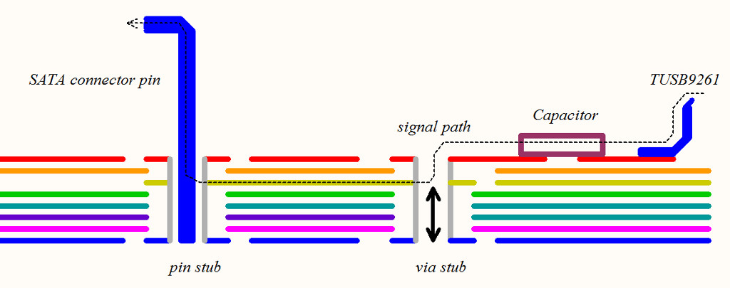

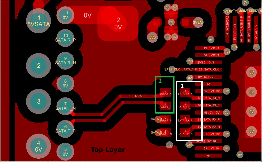

  • Further to the possible wiring error, I've read that the capacitors should be mounted on the rear of the board and adjacent the connector, presumably to limit "stubs". This was not done on our board.
    The caps are on the top layer and the Tx lines continue on the top, while the Rx lines drop down two layers (of 8), and continue to the pin at that level. So in the case of the Rx lines, there are two stubs, one at the via, and the other at the connector pin. The Tx lines have one stub at the connector pin. The following cross-section of the Rx path should illustrate it.
    Is this likely to be the cause of the problem?

  • Hello Errol,
    The stubs on SATA_RX definitively needs to be minimized, however having those stubs would cause data errors not unreachable link. Can you take some scope capture of the SATA lines to see the signal quality?
    The schematic has one error: Terminal USB_VBUS should not be connected to 1.1V. If the TUSB9261 is going to be actively attached/detacched from the USB host, USB_VBUS shall be connected to VBUS using a voltage divider (See Implementation guide at http://www.ti.com/litv/pdf/slla315d). If the TUSB9261 is going to be in an embedded application where it will be always connected to the USB host, then USB_VBUS can be connected directly to a voltage source, always following the voltage divider implementation which provides a 0.5V to this terminal.
    The schematic does not show the connection from the TUSB9261 to the USB Host, make sure you have the AC coupling capacitors on the USB_SSTX lines of the TUSB9261.

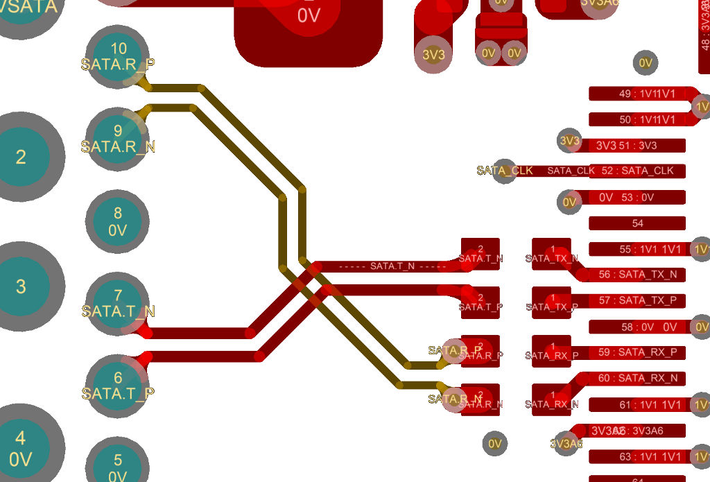

    Is it possible for you to send your board's layout so we can take a look at it and see if that helps to find a solution? Sure. The areas of interest follow. Hopefully screen shots will suffice.

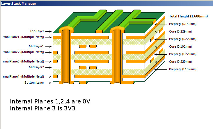

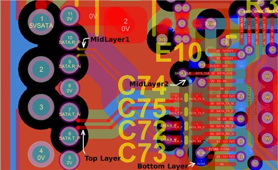

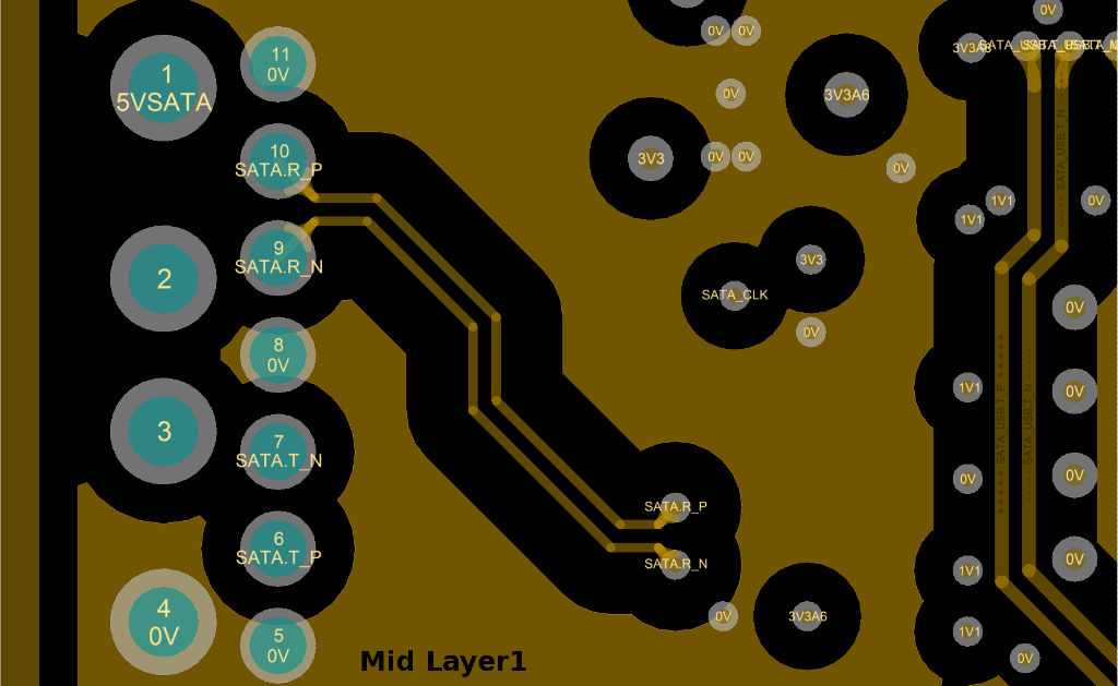

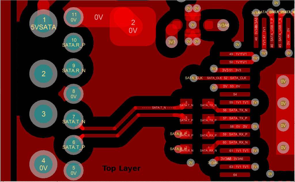

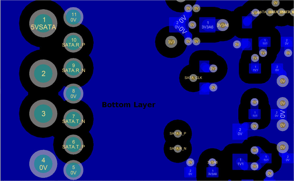

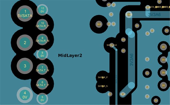

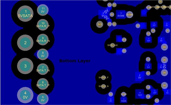

    The layer stack is as follows

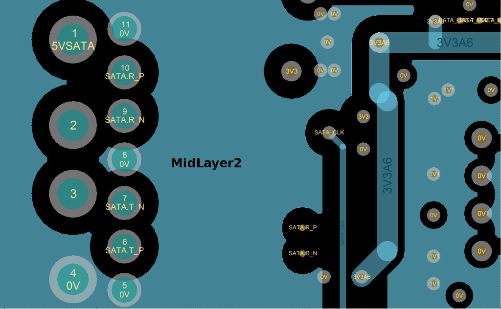

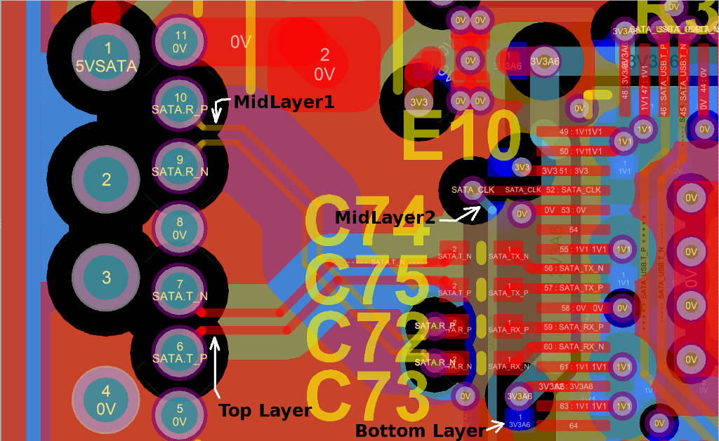

    The full screen shot set, zipped, including internal planes is :-
    5460.eSATAp.layout.zip
    The top layer
    MidLayer1
    MidLayer2
    and Bottom Layer
    a composite shot
    The eSATAp connector mounts on the top, so the signals will have stubs because the traces are on the top and mid layer 1, as per my post of Jul 29 2013 06:38 AM.
    The two vias on C72 & C73 will also have stubs

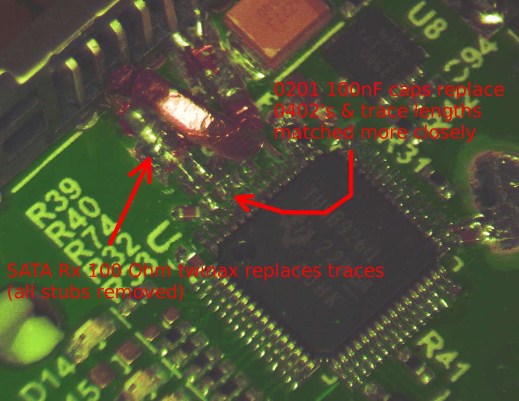

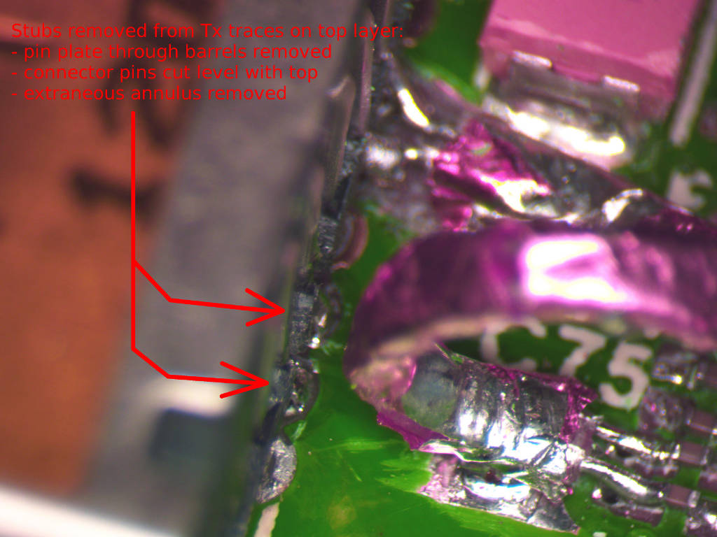

    I drilled out these stubs on a small CNC mill, to the nearest I was game. The connector signal pins were trimmed to effectively surface mount. The traces are still intact, but it made no difference.
    Unrelated but interesting nonetheless - while searching for the fault, I mentioned on Jul 30 2013 23:48 PM that I had cut the SSTX tracks adjacent the TUSB9261 and installed 100n 0402 coupling caps. The USB ceased to operate.
    On one board then, I replaced the 0402's with 22pF 0201's and the USB operated again.
    On the other board, I removed the 0402's and placed a sliver of 30AWG wire, slightly flattened, to bridge the cut track. They were wider than the IC legs, and thicker. It failed.
    I then removed the wire, bridged the cut with solder and trimmed it to roughly the original dimensions using a #11 scalpel. It worked again.
    This proved to me how precise the USB3 circuits must be to operate. SATA is faster still, so I still suspect that the surgery done on one board, to remove the stubs was not precise enough.

  • Hi Errol,
    We made a quick review to the images you attached of your layout and I have some comments (From the Top Lager image):
    1. I can see that each SATA differential trace from the TUSB9261 to the coupling capacitors (SATA_TX_N/SATA_TX_P and SATA_RX_P/SATA_RX_N) differ in routing. Did you make sure that those differential signals are of equal length or the mismatch is less than 2.5 mils?
    2. SATA.T_N and SATA.T_P traces are routed with an angle when connecting to the coupling capacitors. It would have been better if those traces were straight (just a thought). For this:
    3. The separation of the SATA coupling capacitors could’ve been reduced.
    Besides those comments/observations, I couldn’t find anything else from your layout's images you attached. So regarding the SATA lines routing, basically if you followed the recommendations of the ‘TUSB9260 Implementation Guide' (section 4.1) (http://www.ti.com/lit/an/slla301c/slla301c.pdf) there shouldn’t be any issues at least on SATA part.
    Please let me know your thoughts.
    Alexis Cortes.

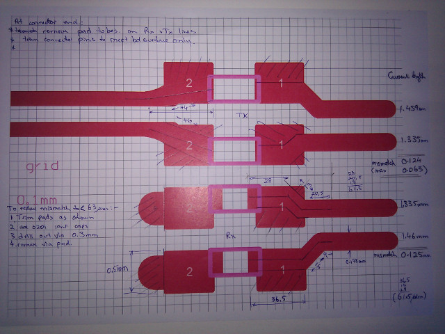

  • Hello Alexis,
    we haven't forgotten about this problem, it's just been shelved while other parts of the board were addressed. There has been a lot of discussion about it though.
    As regards your three points:
    1 & 2. the mismatch on each pair is zero from the caps to the connector, but from the IC to the caps is woeful. The angling has given us a 0.125 mm mismatch (4.9 mils) If we change to 0201 caps and place them on the bottom side we can correct that.
    3. 0201 caps will improve this
    Other points raised amongst our group:
    1. Each capacitor pad has a ground plane only 0.152 mm below. This will create an 0.066pF capacitance to ground at each pad, reducing the impedance. We aim to put a plane cutout under these pads
    2. similar to 1., but for each high speed TUSB9261 pad
    3. There is a stub under each of the pins of the TUSB9261 due to the positioning of the pins on their pads. This stub is between 0.7 mm and 1.7 mm, depending on the vagaries of the TUSB9261 S-QFP--G64 package and our choice of footprint. We plan to change our footprint to reduce the stub variation from 0 to 1mm
    4. All bypass caps are on the bottom of the board and therefore in series with inductive vias. We plan to move as many as possible to the top, as close as possible to their respective supply pins.
    5. We will remove via donuts on the middle layers where not needed, to reduce capacitance
    6. We will use antipads adjacent to the SATA differential lines, in an attempt to maintain impedance as it tracks from the top to the bottom of the board
    7. The clock jitter is to be checked
    8. The capacitors will be moved to the bottom of the board to eliminate via and connector pin stubs
    What are your thoughts?

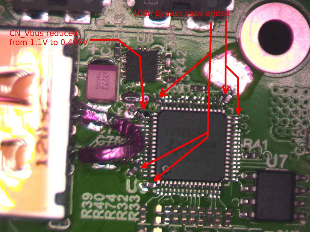

  • Hello Alexis, et.al.
    I've tried various things in an attempt to get this running, to no avail.
    25MHz clock: no overshoots. 1.8Vp-p. Rise and fall times of 5ns. It's clean. It is created by an LMK00105 which has a maximum jitter of 30 fs. Well within the TUSB9261 requirement.
    Supply Bypassing: 100nF direct to the pin where possible on both the 3.3VA and 1.1V lines as per the following.
    Using a Rigol 200MHz CRO, I've measured the 3.3VA and 1.1V noise at under 15mVp-p.
    I've used a potential divider on the Vbus pin to reduce the voltage from 1.1 to 0.497V
    On the SATA side, I've replaced the 0402 decoupling caps with 100nF (didn't have 10nF) 0201's and cut traces from the existing pads in an attempt to reduce the length mismatch.
    My calcs show that the mismatch is now down from 125 um to 61.5um (1.7mils). Practically, I believe it to be better than 2.5 mils, but can not measure it.
    On the Tx side, I drilled out the connector pin plate through barrel to leave the top annulus. The connector Tx pins were cut off level with the top layer and bent out to meet the annulus. The rest of the annulus was cut off to leave an arc. With this mod, the stubs are reduced to zero.
    (It's a bit hard to see what I did, but you can see where I did it)
    On the Rx side, I removed the vias to the inner layer traces from the decoupling caps, and removed the connector plate through holes and annulii. The connector pins were shortened and bent to touch the top surface. The receive connection was then completed with a small loop of 100 Ohm twinax. This reduced the stubs to zero.
    With all of this work, still no joy.
    I have buzzed out the lines from the decoupling caps to their respective points on a remote eSATAp device and confirmed that the hardware connections are correct. I've also checked the same lines from the demo board, to cross check.  The fault doesn't lie there.
    I have seen activity on the Tx traces using a 200MHz CRO, but haven't been able to connect the Tektronix DSA72004 digital serial analyser we have on loan. When it becomes available, I plan to look at both the Tx and Rx signals on an eSATAp-CFast bridge. I will then be able to compare the signals when connected to my circuit and the Demo board.
    Other than the last point, I think I've covered all of the bases. The only real difference between the demo board and mine is the configuration. It swaps the Tx plus & minus lines, only, whereas mine swaps the Rx plus & minus lines, only. I'm starting to suspect the firmware.
    Has anyone used "TUSB926x_FW_v1.02_SATA_POLARITY_SWAP_RX.bin" with success?
  • Hello Alexis,
    in desperation, a cable was modified that swapped the polarities of both Tx and Rx. Then the TUSB9261 was programmed with TUSB926x_FW_v1.02_SATA_POLARITY_SWAP_TX.bin, that used in the demo board.
    IT WORKS!
    What I need now is a version of TUSB926x_FW_v1.02_SATA_POLARITY_SWAP_RX.bin that works.
    Please.
