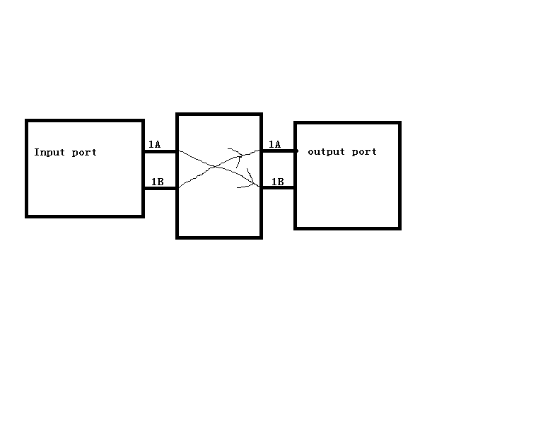

Q2: For the layout more convenient, he also needs to cross the internal logic, like input 1B, then output 1A; input 1A, then output 1B.
Please check the attachment. For this question, how to configure the registers?

    Q1 - To invert data polarity, the user should flip sign for each of the FIR taps for the channel where the output is being observed. If data received at channel 0 is being routed to channel 1 via the crosspoint, then the user should adjust the FIR settings for channel 1.
    Q2- Below is an example to show the register writes necessary to configure Quad 0 such that the input of channel 0 is routed to the output of channel 1, while the input of channel 1 is routed to the outputs of channel 0.

    Note that in this example channel 1 was assigned master control over channel 0’s EQ. Since
    channel 1 is the only channel connected to the EQ of channel 0, it must have master control over
    the EQ.
    Continuing with this example, if it was desired to switch back to normal operation where channel
    0 gets its data from the EQ on channel 0, then the cross point enable bit can simply be disabled.
    Users should avoid turning off both the local buffer and multi-drive buffer when using the cross
    point. When configuring for a point to point switch, users should have both the local and multidrive
    buffer enabled.
