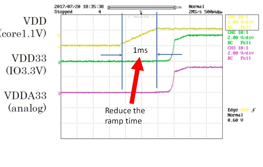

Dear Specialists,
My customer is encountering recognition error at power up.
He conducted comparison experiments between TUSB9261 Demo Board and Customer's board.
From the results, it has a relationship power up sequence and waveform between  VDD(1.1V core), VDD33V and VDDA33.
Could you please advise what is a problem and work around.
I appreciate your great help and cooperation in advance.
