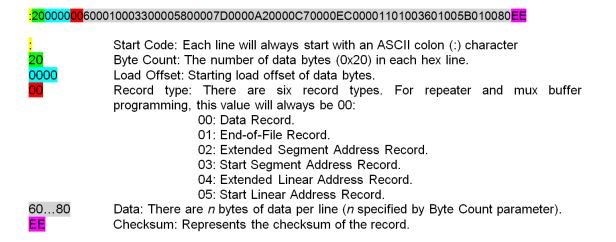

Hi Ian,
I went through SigCon Architect to first generate the .hex file, then used hex2bin to translate the file to .bin.
The .bin and .hex files have been added to the previous attachment you provided me.
Next time, please refer to the following post for details about how to create a hex file so that you can create these .bin files in case there is need in the future: https://e2e.ti.com/support/interface/high_speed_interface/f/138/p/583561/2143136
Hi Ian,
Yes, I believe this is done correctly! For future reference, a good, free tool you can use to check on the .bin file contents is Hex Editor Neo. From there, you can check the contents of the .bin file with the contents of the .hex file. Note that Hex Editor Neo will parse out everything except for the data. In other words, you will only see the gray portion when viewing the .bin file in Hex Editor Neo.
I'm curious about the contents of the .bin file and whether this is just a simple test or an actual hex file. I ask because it seems like all the registers in each of the EEPROM slots are programmed to 0x00.

Hi Ian,
I tried with several profiles to load in the .cfg file, but it seems like you used a profile other than the DS100BR111 to generate the .cfg file. Using the incorrect profile to log a .cfg file results in a parsing error.
Can you let me know which profile you used to generate this .cfg? From there, I should be able to help you create the .hex file.
Michael
Hi Ian,
Please see the corrected hex file and bin file attached.
I think what you may have been doing is setting the correct configurations in the High or Low Level Page, but not updating the EEPROM slot from the device settings. You must click "Update Slot From Device" in order to update the highlighted slot (note that Device 0xB0 in Slot 0 is selected in the "Address/Slot list Section" table). Afterwards, you can "Write to EEPROM Hex" file to generate the hex file.
After ensuring that Slot 0 is updated, I generated the hex file, then used "hex2bin.exe" to create the binary file. Note that this binary file assumes that only 1 device with Address 0xB0 is being programmed. You will need to add "No. of Device" in the top left in order to program more Slots.
