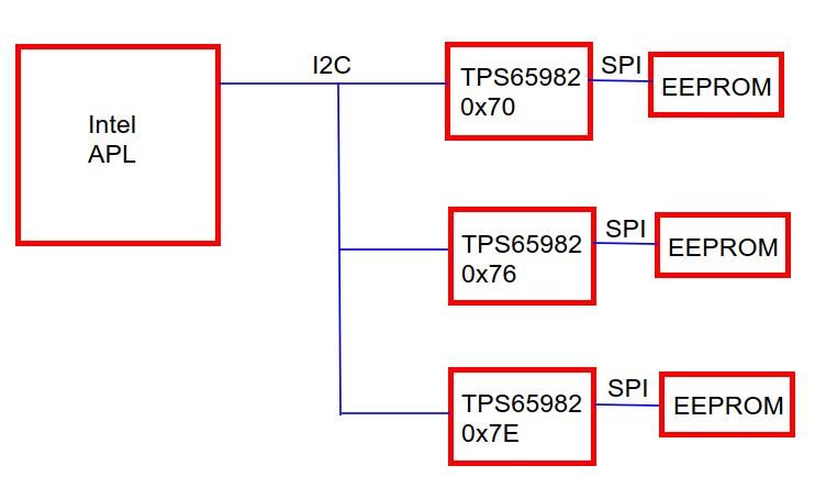

  • Hi Eric
    Maybe i did not explain clearly my problem.
    As below is my system block diagram.
    We have developed FW update tools.
    Can also be the correct update FW.
    So I2C address is no problem
    Now customers have USB3 needs
    So we will USB3 function enable, but this FW version only 0x70(IC1) this port can work.0x76(IC2) and 0x7E(IC3) port not work
    If i exchange the IC1and IC2 address, then the IC2 is work, IC1 not work.
    All port DP functions are workable before FW change.
    After replacing the enable USB3 function FW only 0x70 this port DP and USB3 work
    This problem seems to be related to the I2C settings.
    How do I configure FW?

  • Hi Tim,
    The correct I2C address needs to be set for each independent device in the Application Customization tool. Are you sure the addresses you wrote are correct? 0x70, x076, and 0x7E do not seem to be I2C address options for the TPS65982. Can you do an I2C address sweep on your I2C bus to confirm that those addresses are correct?
    Once you know what the I2C address is, you can adjust the setting in the General Settings tab of the application customization tool. The "I2C_ADDR", "DBG_CTL1", and "DBG_CTL2" pins can have an effect on the I2C address of the device and can be set in the Application Customization tool.
    Thank you,
    Eric

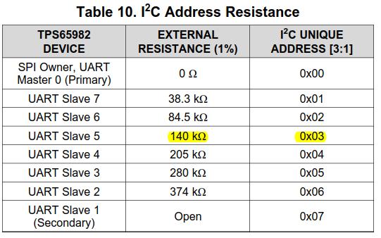

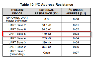

  • Hi Eric
    0x70 is write address, Salave address is 0x3b
    I have some confuse.
    140Kohm  is 0x03 of ADDRESS [3:1] in the datasheet,but in the configuration tool is 220Kohm .
    As below highlight.
    What value is correct .
    Have over 1K pcs board use 140K ohm on customer hand.
  • Hi
    Have any update?
  • Hi Tim,
    The 0 ohm setting relates to 0 ohm
    the 38.3k ohm setting in the datasheet relates to 93.1k in the tool
    the 84.5k ohm setting in the datasheet relates to 156k in the tool
    the 140k ohm setting in the datasheet relates to 220k in the tool.
    Have you done an I2C sweep to ensure that the I2C addresses on your boards are what you expect them to be? Doing an I2C sweep will confirm the I2C address of the master and slave. Also, please note that the TPS65982 can only be an I2C slave on both I2C1 and I2C2. The TPS65982 does not have the ability to be an I2C master.
