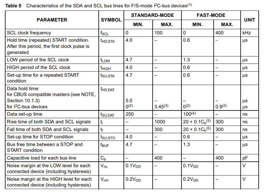

I was able to communicate with the SN65DSI85 EVM using I2C address 0x2D and now I am trying to communicate using the I2C from a microcontroller. I get an io bus address failure when I use 0x2D as the I2C address. Can you confirm?The datasheet (sec 7.5.1 Local I2C interface overview) mentions that the Addr = 1, the address cycle is 0x5A (write) and 0x5B (read) but I dont set these address with Aardvark and I am able to read correctly from the EVM. Can you confirm if I'm missing something?
