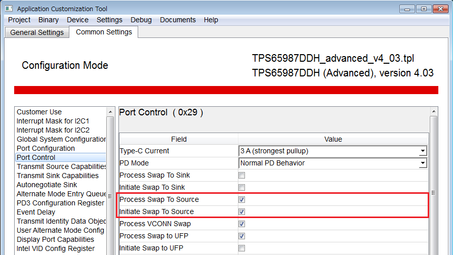

  • Hi Kedar-san,
    Thank you for your kind support.
    Regarding 1), I would like to ask an additional question.
    I believe the following process in application customization tool can meet the following requirement.
    >Source power to note PC that is connected to Type-C receptacle of the application
    Is my understanding correct?
    - Select "Advanced"
    - Select "Dual Role Port (DRP), prefers power source"
    - Confirming to check the following red boxes.
    Yaita
  • Hi Yaita,
    To source 60W, you want to make sure TPS65987D has a source PDO configured for 20V, 3A. This can be checked and changed in Transmit Source Capabilities Register (0x32)
