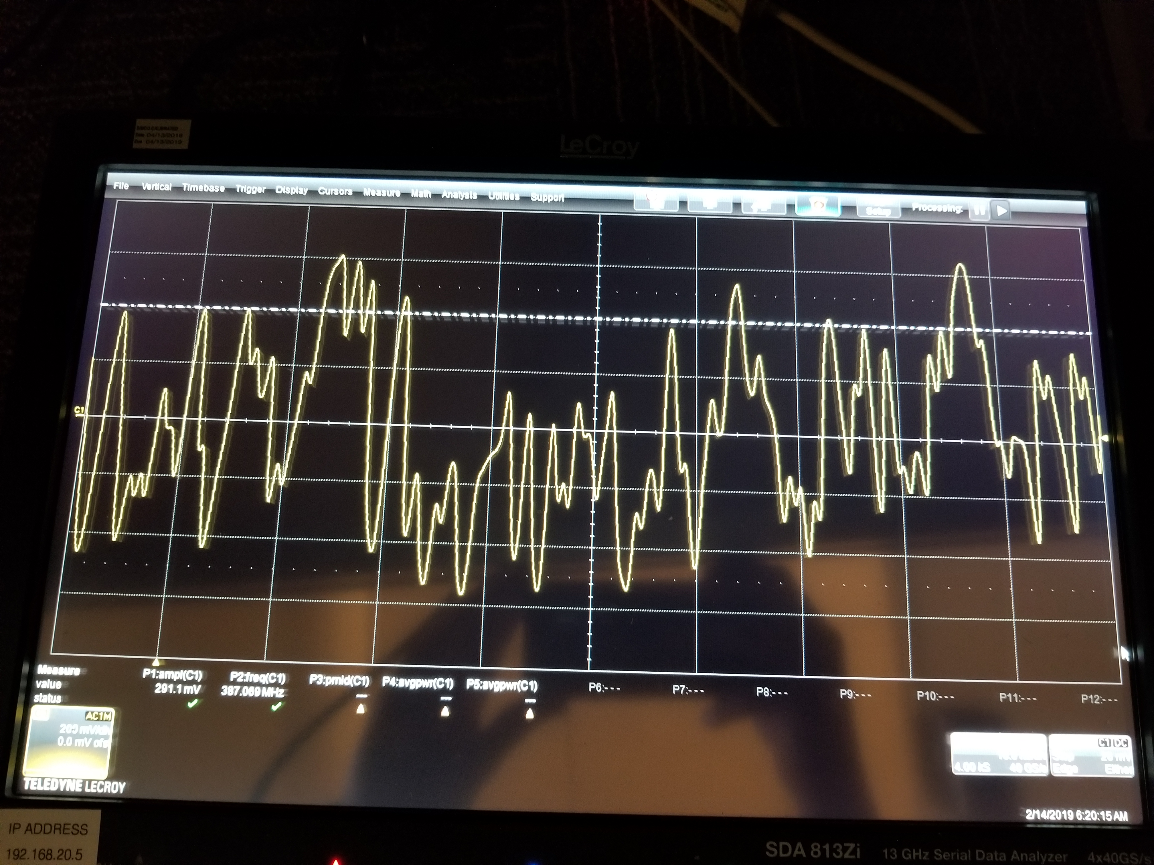

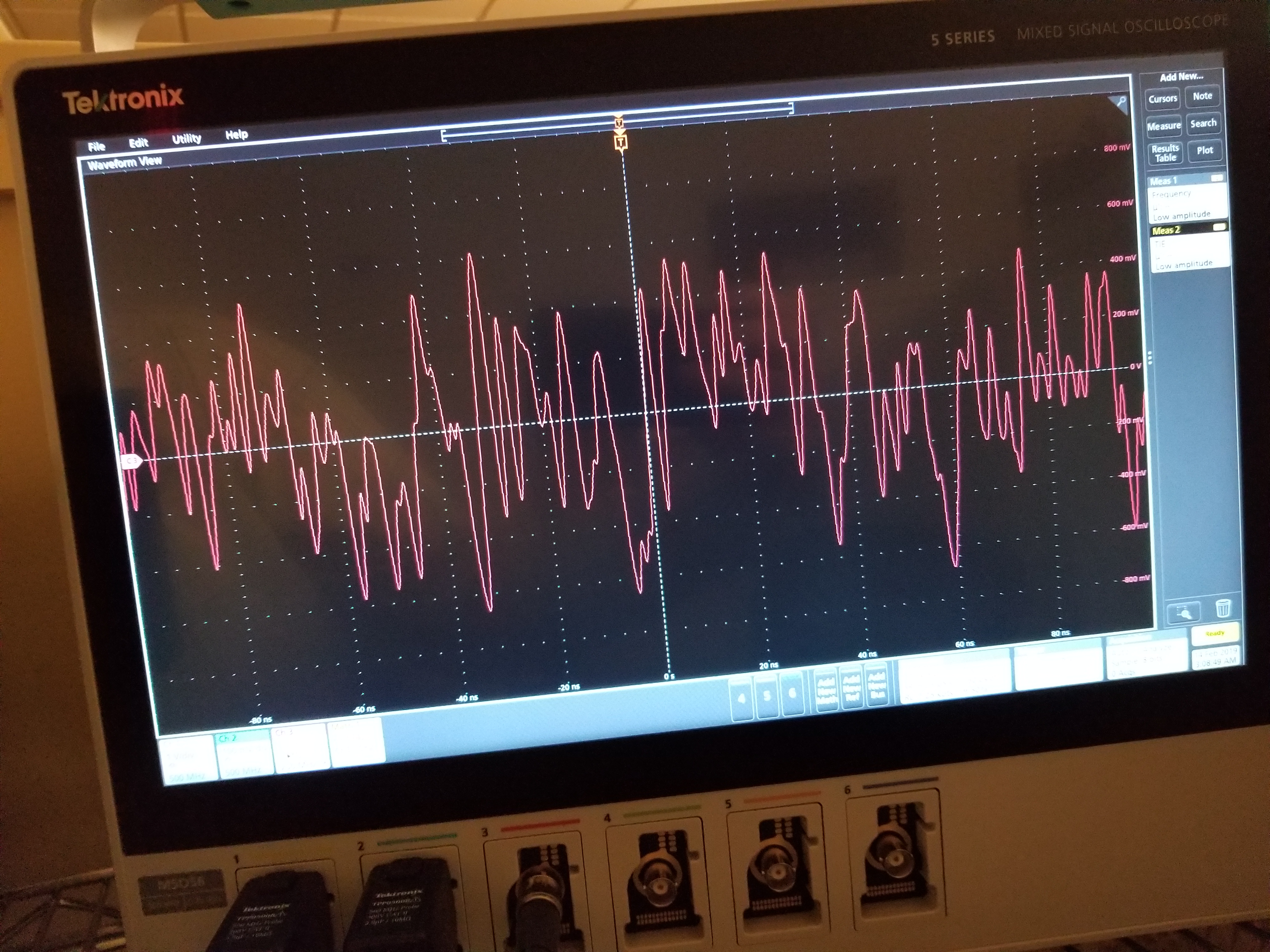

  • What horizontal and vertical resolution do you want to see?
    i used 2 different scopes
    The first picture is 200mV/div 20ns/div (red plot)
    the second picture is 200mV/div 10ns/div (yellow plot)
    I am not sure what the sdi signal should look at or how to analyze it.
    some more information...  if i take the signal from the converter box and route it back into an sdi to hdmi converter box it works fine regardless of the cable length.  test patterns do not work either, same results.  if the receiver has adaptive equalization why would it be over equalizing the signal?  why would i have to bypass equalization for it to work?
  • Hi Joe,
    1). I didn't get your point saying "test patterns do not work either". Could you please clarify.
    2). With adaptive EQ and short cable, device should be able to equalize. In your earlier test, you took output of the FPGA , used LMH0303 cable driver, and a short cable. Under this condition, it worked fine. So I don't think there is over equalization here. I think there is something related to the signal on this HDMI to SDI converter and this is why we asked for scope shot. Can you please set your scope so we can capture output eye diagram. We need to see one or two unit interval of the eye diagram.
    Regards,,nasser
  • Hi
    1) the test patterns you mentioned would probably work, they don't. no video works through the SDI equalizer with a short cable unless equalization is bypassed
