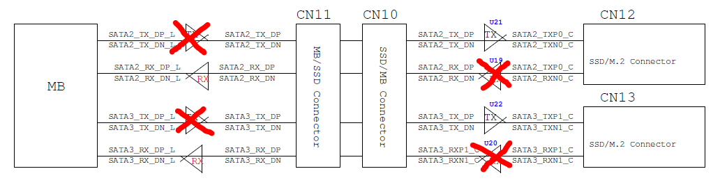

May we know the performance after we put SN75LVCP600 in my board?
My eye paten as enclosed file. is it can be improve?
And may you pls also check my place location?

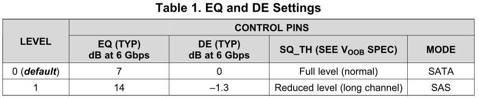

The LVCP600 should be able to increase the eye height to meet the eye mask.
