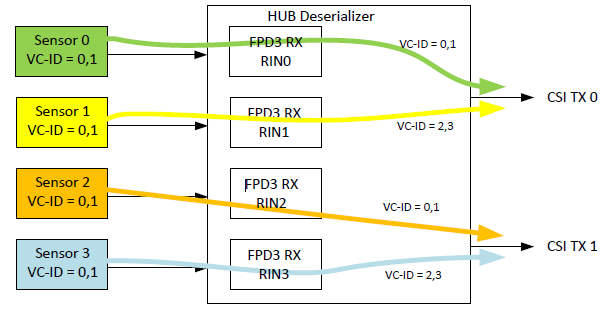

HI Sir
We are
DS90UB960---DS90UB953
and
Use four cameras.
'1920x1080 YUV422 8bit MIPI 2Lane'
Each camera output has been confirmed.

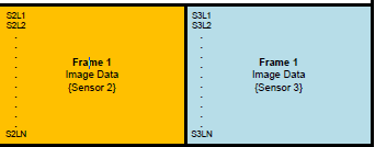

What we want to do is
RX0, RX1 => CSI 0 port.
RX2, RX3 => CSI 1 port
As above, two cameras are output to one Csi Port
It is output at 3840(1920*2) x 1080 resolution.
I have set the DS90UB960 for this, but it does not work.
This is the register we set.
once 2 camera(rx0,rx1 to csi port0)

  • Hi Choi,
    Are you using a DS90UB964-Q1? The register dump is from a 964 device.
    Also, what is not working? It appears you are getting video but is it just not concatenated?
    Also how much video data are you trying to output? Like to total line rate per csi lane?
    Additionally, why is Register 0x1F=0x07, which would have the Des set to output 400Mbps. Is this intentional? From your configuration, I think you are outputting more than 400Mbps/lane.
    Mandeep Singh
  • Thank you for quick response.
    I doubt it either. The module(H/W) is printed on the DS90UB960-Q1.
    It does not operate (output) when two rx is set to one csi port.
    I want 4 lanes to be output(3840x1080) on one CSI port.
    It is not intentional.
    If it is set higher than 400Mbps, the image will be output and then stopped.
    Choi
  • Hi Choi,
    Are you trying to output from the 960 CSI port in 2 lane or 4 lane?
    You have the SER recieving 2 lanes and that is okay but you are outputting 2 lanes currently on the DES and with what I calculated below for the total video throughput (~1.244G/lane for 4 lanes = 4.976Gbps), there's not enough bandwidth on the CSI port to output all the data in 2 lanes. The max CSI output on the 960 in 4 lanes is 6.4G/lane. In 2 lanes, the max you could output is 3.2G/lane. With the amount of data you are trying to ouptut, it should be 4 lane. If that's correct, can you set register 0x33[5:4] = 00 on the DS90UB960-Q1.

  • Do you have any input CSI limitations on your SoC? If setting 0x1F = 0x00 on the 960 is causing issues then it's possible that the SoC can't handle 1.6G/lane of data. Can you confirm? Does setting 0x1F = 0x02 have any issues?
    This is not correct, Register 0x71 and 0x72 are there for when the DS90UB960-Q1 is in backwards compatiblity mode and is configured for RAW operation. When using the DS90UB953-Q1 with the 960, you are always in CSI mode. The only register that you need to configure is 0x72 on the 960. That register is used to configure the Virtual Channels. If both of the sensors coming in have a VC of 0 then set 0x72 = 0xE4 for Rx0 and 0xEA for Rx1. This will set the VC of 0 for Rx0 to VC= 0 and VC of 0 for Rx1 to VC=2. If the incoming VC's are not 0, then please set register 0x72 accordingly to that.
    print "*** RX0 VC=0 ***"
    board.WriteReg(0x4C,0x01) # RX0
    board.WriteReg(0x72,0xE4) # VC0
    # print "*** RX1 VC=2 ***"
    board.WriteReg(0x4C,0x12) # RX1
    board.WriteReg(0x72,0xEA) # VC2
  • HI
    I checked again.
    There is no problem even if 0x0f = 0x00 (1600).
    0x0f = 0x02 (800) There is also no problem.
    But still
    rx0,1 -> csi port does not work with 0.
    Data can not be measured when checked with an oscilloscope.
    rx0 -> csi port 0, rx1 -> cxi port 1 will work fine at the same time.
    I set it up as follows
      #print "*** RX0 VC = 0 ***"
      board.WriteReg (0x4C, 0x01) # RX0
      board.WriteReg (0x72,0xE4) # VC0
      # print "*** RX1 VC = 2 ***"
      board.WriteReg (0x4C, 0x12) # RX1
      board.WriteReg (0x72,0xEA) # VC2
      # board.WriteReg (0x1f, 0x02) # 800 clock
      board.WriteReg (0x1f, 0x00) # 1600 clock
      board.WriteReg (0x21,0x3c) # "*** line concatenation ***"
      board.WriteReg (0x33,0x01) # 4lane
      board.WriteReg (0x20,0xcc) # rx 0,1 to csi 0

  • Hi Choi,
    I noitced you are not providing a framesync signal unless it's external. If you are not, can you please follow the example in the DS90UB960-Q1 Datasheet section 7.4.24.2.1 to enable the internal framesync.
    Additionally, as a reference, when enabling/disabling CSI transmitters, you should be following the procedure in section 7.4.25.8 to avoid any issues.
    Mandeep Singh
