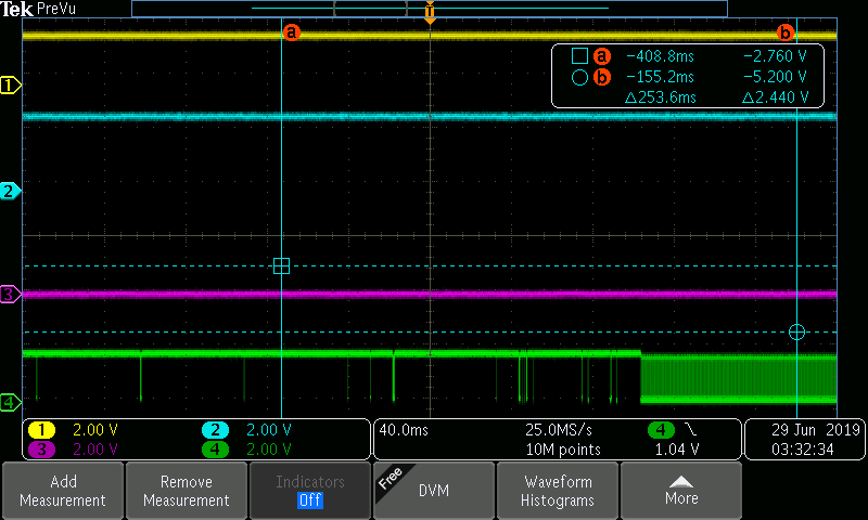

  • There are 2 different behaviors observed.  In the scope plots below the traces are:
    Yellow = 1V8
    Blue = LOCK
    Green = SCL
    You can see that in one case the SCL line is held low for 254ms.  I assume this is the 954 clock stretching for the entire BCC Timer period from register 0x07 of the 954.  In another case with the same software initialization, there is no long duration of SCL being held low.  Both cases have the same ECU with 954 but each picture has a different remote 953 camera attached.  In both cases, the initialization is looking for a device that is not present in either system.  However, when attempting to read status of the non-present device there are 2 different behaviors.
  • Hi Mark,
    I need more clarification on this. Are you using one 954 connected to two 953s? Or two 954s, each connected to a 953 on RX0? Or are you using the same 954, and just swapping the 953s?
    Can you also provide the register settings/dump for the two cases for us to compare? As well as the more zommed in scopeshots on the SCL line when it's supposed to pull-low.
