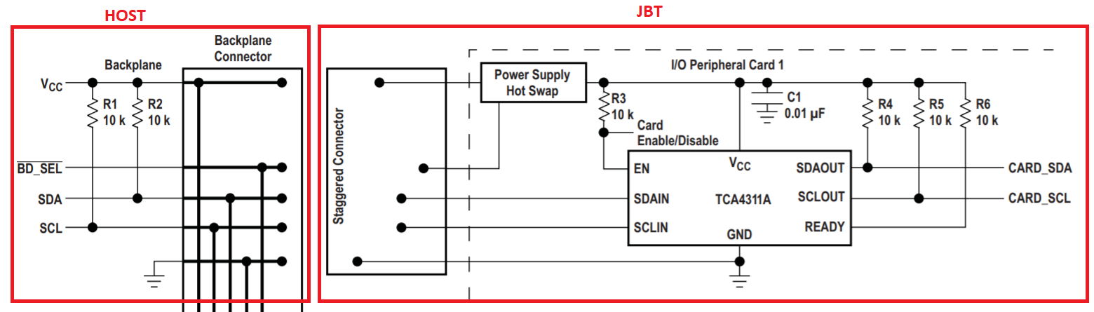

We design TCA4311 enable when power on directly as below diagram we have in our datasheet.
My customer is asking if they unplug the HOST board, what the behavior in JBT side TCA4311? will the SDAIN/SCLIN be always low?
And how the TCA4311 operate when HOST board re-plug?
Could you please help to explain more details on TCA4311 behavior?

  • Hi Bobby,
    Thanks for your feedback and we have more questions from our customer need your help to answer it.
    The power supply design are separate for both HOST board and JBT board which means when HOST board unplug, the JBT board still powered. And the HOST board and JBT board connect by a cable which only include I2C SDA, SCL, GND signal.
    Q1. When HOST board unplug, we will see the TCA4311 on JBT board SCL_OUT goes low and other devices on this path can’t be recognized.
           And after we re-plug HOST board back, it will no issue. May I know the reason of why the SCL_ out will goes low?
           Below I the details TCA4311 schematic on JBT board.
    Q2. There is only pull up resistor in the TCA4311 SDA_OUT/SCL_OUT local side, is it be fine for the design?

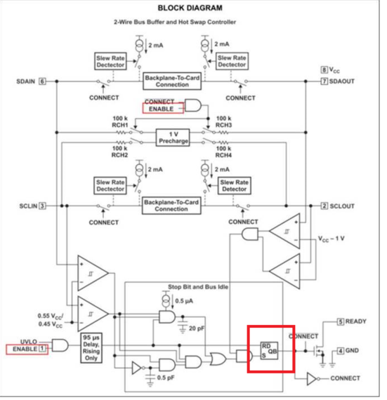

    Q3. Is the red box is SR latch? And what is the stop bit and bus idle function?
  • Anne Wu said:
    Hi Bobby,
    [Bobby] It looks like this is because the pull up resistor is on the Host and there is no pull up resistor on the 'in' side of the JBT board. So the IN side of the device may just float to GND.
    [Bobby] It sounds like you intend to use the device while not connected to the main board which means pull up resistors need to be on the in-side if there is another master on the daughter card who needs to communicate on the I2C bus. Alternatively, the master on the daughter card could also just disable the device by pulling the enable pin low when it is not connected to the main board.
    [Bobby] stop bit and bus idle are part of the I2C spec and the in-side of the 4311A looks for these conditions inorder to connect the two sides together after a hot insertion event occurs. And yes, that should be some kind of digital latch.

  • Hi Bobby,
    We have following questions on Q1 & Q3 after your reply and add one more question on Q4,
    Please see below and help to advice it.
    Thank you.
    [Anne] Customer is asking our application diagram in our datasheet didn't mention about the pull up resistor in JBT side, but only HOST side.
                If customer needs to add pull up resistor in both HOST and JBT side, how could they design?
                Their current design need to support hot-plug when TCA4311 power always on and enable pin will always high.
                Please help to advice it.
    [Anne] If we connect In/Out inverse, what will happen?

  • Hi Bobby,
    we are still waiting for your feedback, please help on it.
  • "About the enable pin, should we need to use the enable/disable function to connect to the cable present for Hot-plug detect?"
    If you only have a pull up resistor on the out side and not the in side and want to use the device when unplugged, then you need to disable the device when unplugged. The backplane should enable the device when hot plugged. (Hotplug-->enable)
    "Or we can keep enable pin always high no matter cable is plug or unplug."
    Leaving the enable high is likely the reason why you were seeing this problem "When HOST board unplug, we will see the TCA4311 on JBT board SCL_OUT goes low and other devices on this path can’t be recognized."
    " If customer needs to add pull up resistor in both HOST and JBT side, how could they design?"
    If you do this, then you lose the 1V precharge feature. The point of the pull up resistors on the backplane is to allow the device to power up before it makes connection to the backplane and you do not want to pull the voltage up to Vcc before it makes connection to the backplane.
    "Their current design need to support hot-plug when TCA4311 power always on and enable pin will always high."
    This device was not designed to support a powered on hot insertion and then unplug while being enabled at all times. If you populate the in side with the pull up resistor on a powered on daughter card you lose the 1V precharge during hot insertion. If you have the enable high while the in side is not HIGH due to no pull up resistors, then you risk the inside floating to low and driving the out side low. The best solution to this is place a pull down resistor on the enable pin which gets enabled after a hot insertion event occurs.
    "[Anne] If we connect In/Out inverse, what will happen?"
    Both in and out side are then connected together. Based on your design, when you remove the daughter card, then in side can float low since there is not a pull up resistor on that side and can drive the out side low.
    -Bobby
  • Hi Bobby,
    How will be the impact about the 1V precharge?
    And could you please help to explain more details about why the input is floating will cause the output goes low?
  • user4979899 said:
    Hi Bobby,
    The 1V precharge on the in-side of the device turns on when the device itself powers up for the first time and only works when there is no pull up resistors on the in-side. It is meant to be used to help the signal on the backplane see 'less' of a glitch when you insert additional capacitance to the live backplane.
    If you have an input and it is not referenced/biased then the signal could change due to parasitics in the PCB due to crosstalk or even from the environment due to the electromagnetic force being induced into the copper to generate temporary current and building a charge onto the pin. Typically an input will float to GND because it discharges itself through air/another medium. This means the input can temporarily see a HIGH or LOW. If the input goes low, then the output also goes low. This is assuming you are leaving the in-side without a pull up resistor and the 1V precharge has already been deactivated after inserting and removing the daughter card.
