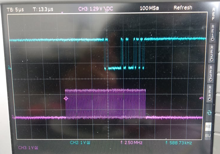

    3. MDC signal shows clock bursts about every second, or more often if I am configuring anything through CLI or in windows. MDC frequency is 2.5MHz. You can find scope screenshots below. This is probably some periodic link-check.

    I connected a scope to MDC and MDIO and decoded the communication between MAC and PHY:
    1. after power up MAC scans all the PHY addresses and tries to red 0x01 register until it finds PHY
    2. reads reg 0x01 val 0x616D
    3. reads reg 0x01 val 0x616D
    4. reads 0x02  - 0x2000
    5. reads 0x03 - 0xA0F1
    6. reads 0x04 - 0x0020
    7. writes 0x04 - 0x0AE0
    8. reads 0x9 - 0x1300
    9. writes 0x9 - 0x0200, 1G FD, auto master/slave
    10. writes:
    0xD - 0x0003
    0xE - 0x003C
    0xD - 0x4003
    0xE - 0x0060
    11. writes to 0x0 - 0x1200 - autonegotiaion restart
    I do understand some of these commands, but I do not know what changes after point 10, and value of point 6.
    Thank you for checking this.
