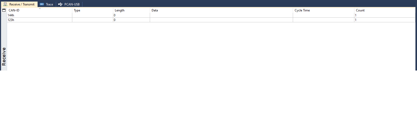

I am working on TCAN4550 with NXP(i.mx 8M Nano board) to be able to transmit and receive the CAN messages .I am using PCAN simulator to see the transmitted and received CAN messages. I am able to receive the message from TCAN board to NXP board  but while transmitting the CAN messages from NXP board to TCAN board am able to send 0 length payload to TCAN4550(CAN message with its message id and Length =0 received on simulator).I have attached screenshot of PCAN simulator .your guidance will be highly appreciated.

    Sorry for the confusion .I am trying to send the CAN messages from my NXP NANO board to TCAN4550 but able to send only CAN message ID and not the Payload .I am able to receive the messages from TCAN4550 to NXP NANO board successfully. Hope this clears the confusion now.

    For register 0x820->GLOBALERR,SPIERR
    for register 0x824->PED: Protocol Error in Data Phase (Data Bit Time is used).
    Only Message id can be seen on simulator. Data length is 0 as mentioned earlier.

    Thanks for this information, it looks like there's some sort of error occurring in your CAN frame from the NXP board during the data portion of the frame. Some CAN controllers are configured to stop transmitting as soon as an error is detected, can you find out if the NXP board is configured this way?
    Is there any way you can capture the CANH and CANL signals on an oscilloscope? Also, since there is a SPI error being asserted, that means that an interrupt in register 0x000C is being asserted. Can you read 0x000C to find out where interrupt that is?

    I can not see the signals on CANL and CANH when used oscilloscope. Also i read the register 000C.I get  "SPI_error_interrupt and Internal_access_active" errors.

    Understood about the CAN bus, if no frames are coming through at all, then it seems to be an issue with the NXP device since TCAN4550-Q1 won't do anything to stop transmission as the receiver. Is there a way to check for any interrupts or errors on the NXP board?

    As for the TX buffer start address, this doesn't need to be 0x8270, it's dependent on your own memory allocation in the application. In the software user's guide, the example used found the TX buffer start address to be 0x8270, but this is not a defined start address.
    Since there is a protocol error in the data phase being reported, the message itself is not completing it's full transmission, so this is why no data is being received. In register 0x1018 bit 6 is the DAR bit. This enables the ability for the controller to continuously resend a message if it was not transmitted correctly. Can you check the status of this bit? I want to make sure it is set to 0 so the controller will continuously send the frame and you can capture the waveform. We need to understand what is causing the protocol error in the data phase to figure this out I believe.
