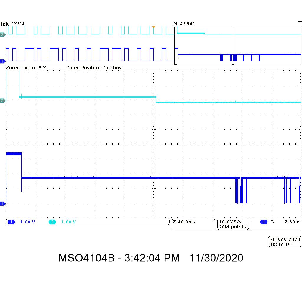

    Can you please attach scope captures of VBUS and the CC lines for the different negotiations?
    Also, can you try different active cables and see if this is an issue with those cables? This could be a cable issue and trying different cables will help us determine if that is a problem.
    Emma
  • The probes are attached to the CC1/2 lines at the PS side of the USB cable. The PS is always ON.
    Can you confirm this issue with different active cables from different manufacturers?
    Can you confirm which scope capture matches which behavior?
    Emma
  • Yes, this happens with other mfr's cables'.
    The 3:43 shot is 'good' at 5A.
    The 3:42 shot is defaulted to 3A.
    The CC line is fully, low during 'good' negotiation.
    There is a funny, 'almost low' state, when it negotiates to 3A
