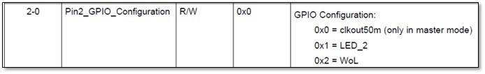

The datasheet mentions on Page 21: “DP83825I WoL logic circuit is able to generate a user-defined event through any of the GPIO pins”.
But the only mention in the datasheet regarding how/which pins could be used is in the below:
Q3. Does that mean that “any of the GPIO pins” actually means “only pin 2” (50MHzOut/LED2)?
Note that in my application I need two separate LED/GPIO pins for following functions:
  1. Link/Activity (must be by default; without programming)
  2. WoL (it’s OK if this requires some programming)
Q4. Do I understand correctly that this is possible with this part, but only RMII Slave Mode (not Master Mode, since that requires using pin 2 as 50MHz Clock out)?
FYR The below table on page 73 of the datasheet is confusing.
I believe the lines that I marked up with yellow highlight below should be deleted from it.
