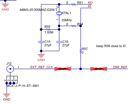

    <Question2>
    In relation to <Question1>, if XI is Pierce oscillator, it seems that R55 of DP83867EVM is unnecessary.(Pleas refer to following circuit.)
    Because there is bias resistance internally.
    Is our recognition correct?

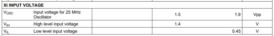

    We would like to confirm VOSC(Input voltage for 25 MHz Oscillator).
    If we use following oscillator for XI, VIH and VIL are satisfied with Electrical Characteristics.
    -VOH =Vcc 90% = 1.62V
    -VOL=Vcc 10% =0.18V
    However, voltage will be 1.62V-0.18V=1.44V, so VOSC(1.5V~1.9Vpp) will be out of spec.
    So, is VOSC 0.9Vpp(typ) like as DP83826? Because XI's VDDIO level is 1.8V, so DP83867's XI voltage level is 1.8V.

    1. Yes XI has an internal bias. We can't disclose the exact architecture here.
    2. Yes R55 is not required.

    4. Sorry I dont think I understand the question.Can you explain a bit more about why are you subtracting 0.18V and what are you referening to when you are saying that vosc = 0.9V in 826?
    Vikram
  • Vikram san
    Thank you for your reply.
    ->In case of DP83826 with VDDIO=1.8V, OSC common voltage is 0.9V. So, we assume that this voltage is the same as DP83867's VOSC.
    And then, when we use  following 1.8V output oscillator, voltage swing will be 1.62V-0.18V=1.44V.
    -VOL=Vcc 10% =0.18V
    If VOS minimum is 1.4V, there is no enought electrical tolerance.
    Therefore, DP83867 XI's VDDIO is level 1.8V, we think that VOSC voltage is 0.9V(typ) the same as DP83826.
    Is our recognition wrong?
    Kind regards,
    Hirotaka Matsumoto

  • Hello Hirotaka-san,
    Thanks for your patience. I got the confirmation from team that meeting VIH and VIL of XI should be sufficient for PHY. Vosc min value is higher than VIH for extra guard band but is not a necessary spec. To remove confusion Vosc min value will be removed and only Vosc max value will be retained in next datasheet revision.
    Vikram

  • Vikram san
    Thank you so much for your reply.
    OK, we would like to confirm the conclusion.
    1. In case of AC-Coupling with Oscillator, Vosc min and Vosc max are necessary for spec(swing level).
    2. In case of DC-Coupling(direct connection) with Oscillator, VIH and VIL are necessary for spec.
    3. In relation to "1.",  if Vosc min is less than 1.4V? or 1.0V?, it might cause packet errors.(Please refer to https://e2e.ti.com/support/interface/f/138/p/805173/2996134)
    So, should we consider using two following ways to be filled with spec?
    -External oscillator : 1.8V LVCMOS type
    -Crystal
    Kind regards,
    Hirotaka Matsumoto
  • Vikram san
    If you have some update, could you share us?
    Kind regards,
    Hirotaka Matsumoto
    Yes your conclusions are correct and Vosc min should be 1.4V.
    Vikram
