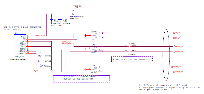

    I've implemented composite bus powered device using TUSB8041. The problem is sometimes the downstream device linked with USB 2.0. If it is soft reset, then it is linked to USB 3.0.
    I've changed reset timing of HUB and downstream devices but not helpful. In addition, sometimes the link is lost. Only after unplug and plug the cable, the link can be recovered.

    How is USB_VBUS to the hub controlled?   Is FULLPWRMGMTz set high?  What is controlling VBUS to the downstream device or is it always on?

  • USB_VBUS connected to USB supply through 90.9K and 10K ohm resistors.
    FULLPWRMGMTz has external pull-up to disable power management. There is no VBUS control, the downstream device is always on.

  • Hi HJ,
    Can you share your schematic?  If the downstream device comes out of reset after the hub, it should always connect at USB 3.0 speeds.  If the device doesn't connect at USB 3.0 speeds, does it always drop to USB 2.0 speeds or does it sometimes not connect at all?

  • Hi, JMMN,
    The downstream device connected at USB 2.0 when it fails on USB 3.0. Could you recommend how much time to delay the reset of downstream device ? and is there any software to monitor the hub device state ?

  • Hi HJ,
    Ok, it is good that it always connects at USB 2.0 if it doesn't connect at USB 3.0 speeds, but this indicates the neither the hub or the device is going into USB 3.0 compliance mode which is the typical cause of USB 3.0 connections not occurring during power on of an embedded system.  What operating system are you running on the host?  Can you confirm that the hub is consistently connecting at USB 3.0 and USB 2.0 speeds.  Can you share the system operation steps?  For example, what order these events typically occur in:
    1. Hub powered on / exits reset
    2. Downstream device powered on / exits reset
    3. Cable connected between hub and host
    JMMN

    As I've mentioned at Mon, Feb 15 2021 2:55 AM . It is a composite device integrated on the same PCB module. This problem happens when it is plugged into the host port. Mainly, I'm using this module on LINUX machine but it is observed on Windows machine also.
    By the way, do you have any advice to modifying schematics ?

  • Hi Sympson,
    I understand that the hub and the device are permanently connected, but are they powered on together?  Are they bus powered?  And are they powered before the host is connected?

  • Hi, JMMN,
    It is bus powered module. DcDc used to supply power to all devices on the module. They are supplied altogether but have different reset timing.
    It consume about 530mA when it fully operate.

  • Ok, the hub+device is never powered on before the host then,  Is it just random that sometimes the device connects at USB 3.0 and sometimes USB 2.0?  Can you confirm if the hub connects at both USB 3.0 and USB 2.0 consistently?
