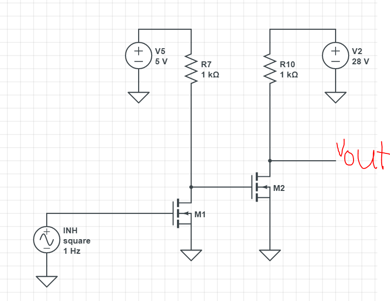

    Customer would like to use INH-pin to drive a gate of external FET as following circuit. Would you please review it whether it would be work?

  • Hi Fujiwara-san,
    Let me know if I am not understanding the circuit correctly. It looks like this is a method to apply power to your voltage regulator when the CAN device is powered up. However this can be accomplished if your Voltage regulator has an EN pin. Is there no EN pin on the voltage regulator?
    It doesn't look like this mosfet circuit would work.
    When a voltage is applied to the gate of M1 the switch would close but there is no voltage from the drain to source of M1. So no voltage would be applied to the gate of M2. Here is my recommended setup.
    Here is what it would look like in your circuit.
    Let me know if you have any questions about this, I know the hand drawing is not the best but the circuit above should be easy enough to follow.
