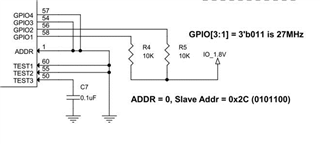

The GPIO3 is used for EDP_BL_ENABLE from EVM circuit and REFCLK is setting 27MHz.
The GPIO[3:1]=011 is 27MHz but GPIO3 also connect to EDP_BL_ENABLE.
is it correct to work?
Please see my response in this e2e ticket, https://e2e.ti.com/support/interface/f/interface-forum/993680/sn65dsi86-mipi-dsi.
