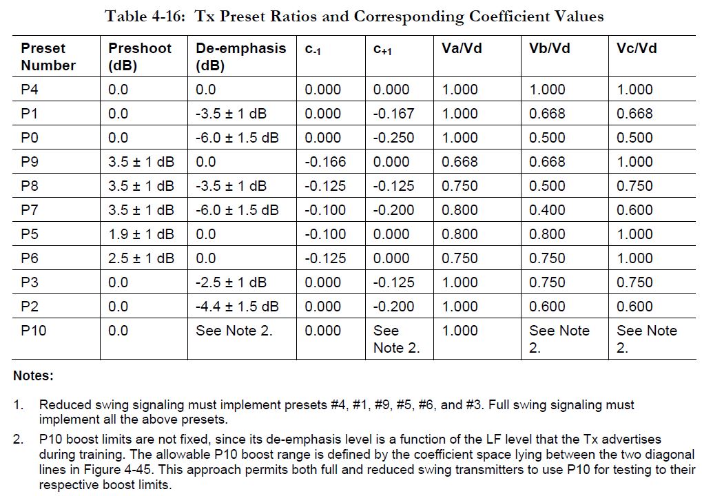

    Thanks for the trained coefficient values. While this is helpful to know, we are actually more interested in the chosen Tx preset used by the CPU (or PLX switch). This allows us to determine how much signal conditioning is "pre-applied" to the waveform already. This corresponds to the PCIe preset value P0-P10, as referenced in the PCIe specifications below:
    Would you happen to the know which preset value is being used in your system? Common preset values we have seen in systems is P7 and P4.
