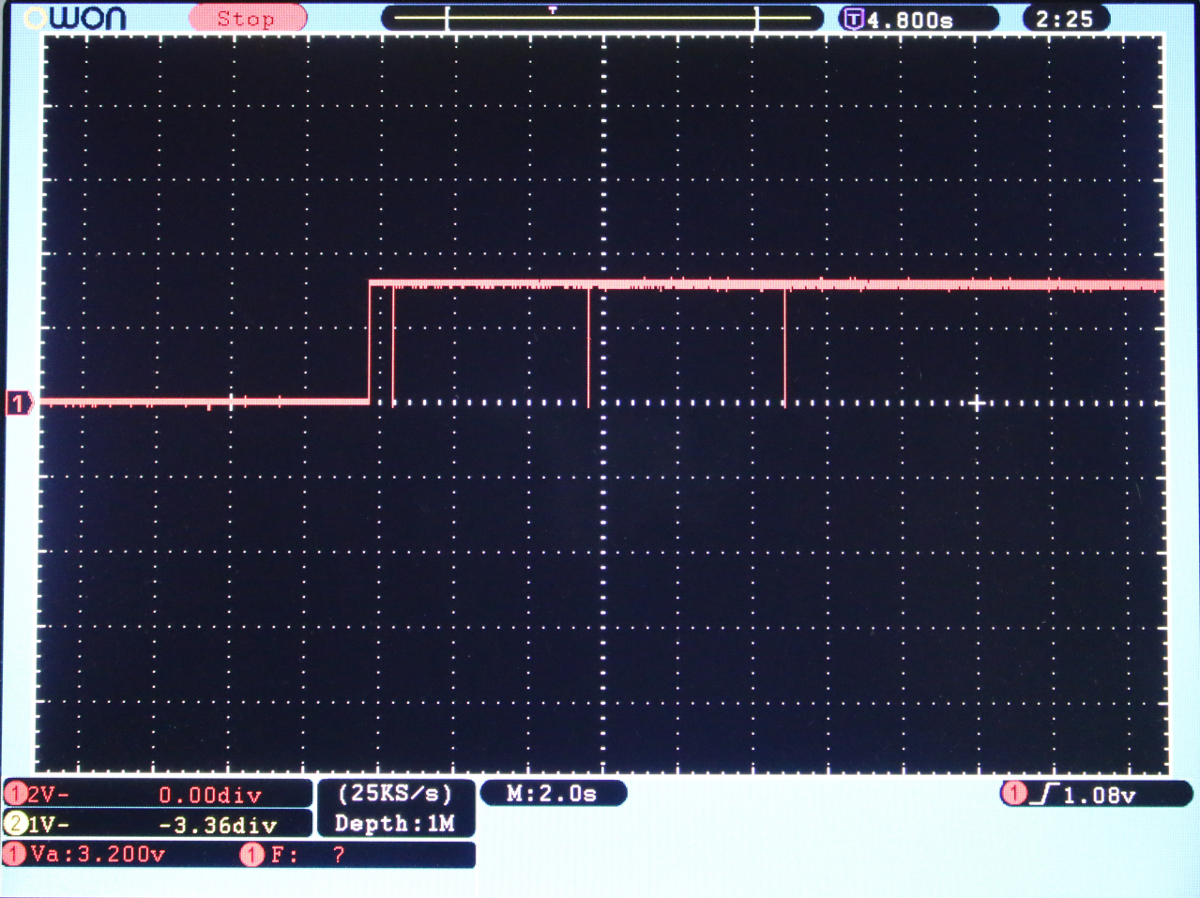

    Ok, thanks. One more thing about DFP/UFP event: when I connect the USB cable connected on other side with USB-Hub, then my GPIO14 (UFP/DFP Event on Port0) goes high but always has 3 low spikes (s. attached). I guess this is not ok. Probably you can find the reason, when checking the firmware.
    Sergey
  • Hi Sergey,
    I got confirmation that the FW is implemented per the TRM so drives high only for UFP.
    The 3 low spikes are likely to be caused by hard reset because the USB hub is a non-PD, the FW tries 3 times.
    Peter
