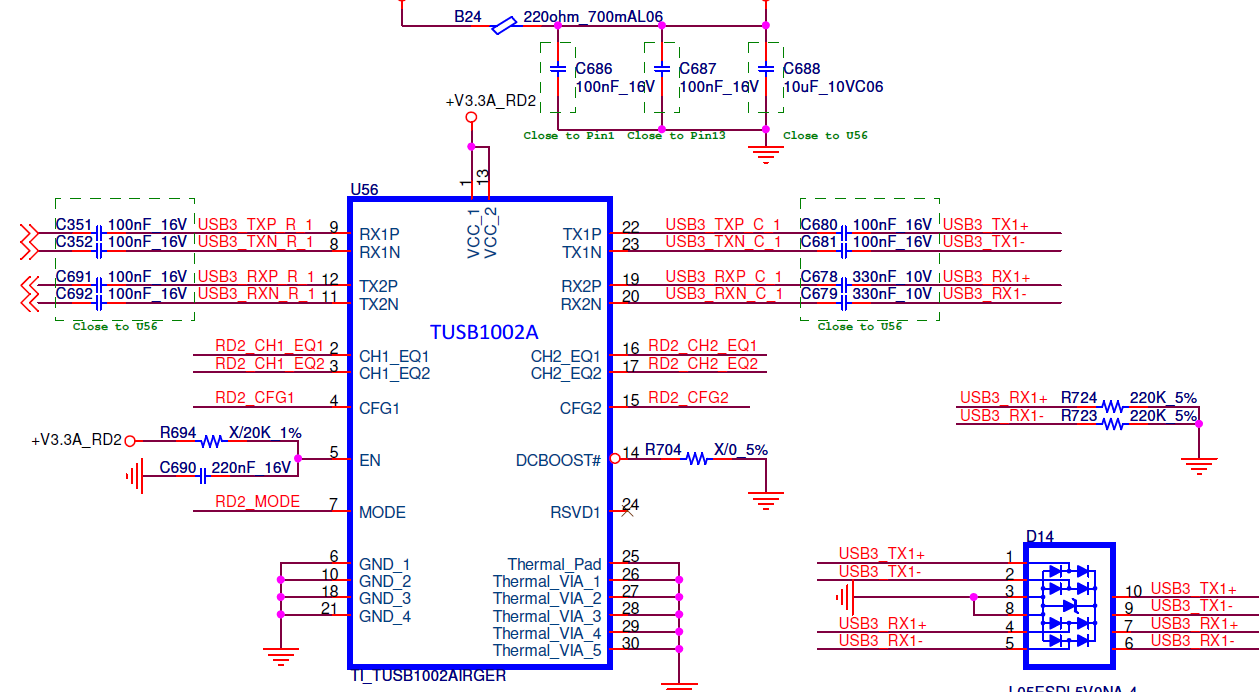

could you help check the TUSB1002A schematic as below and any need adjust?

1. You can leave DC_BOOST and EN pins floating.
2 C676, 677, 678, 679 need to be 330nF instead the 220nF.

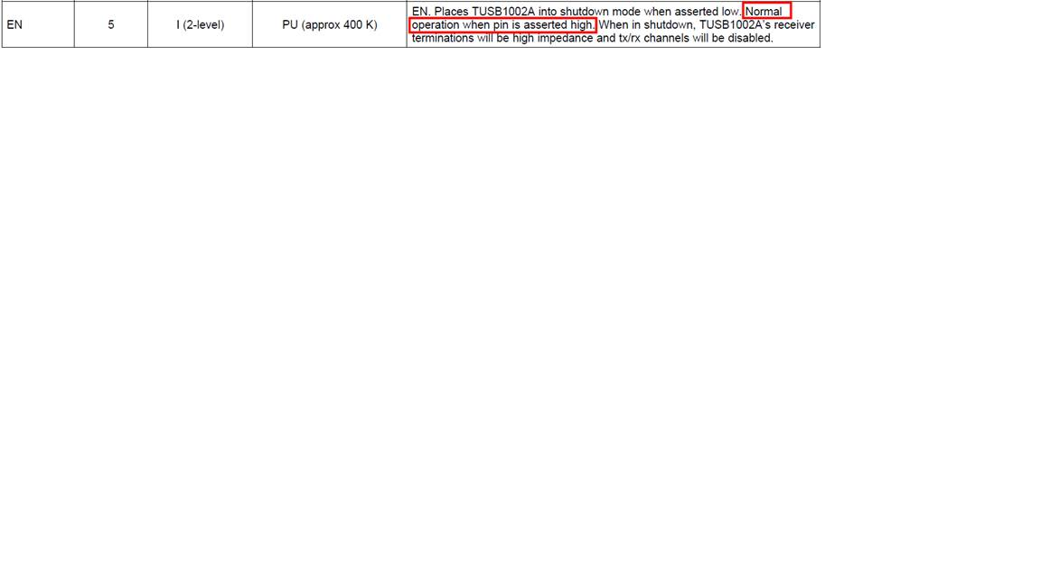

The EN pin already has an internal ~400k pullup, so you can leave EN pin to be left unconnected or tied to a 100nF capacitor to GND.
