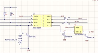

I use ISO1640 as I2C output isolator for PGA900.
But I find I2C SDA rise time is too long. PGA900 SDA rise time is about 240ns without IS01640 in 400KHZ.
But when I connect the PGA900 i2c to ISO1640, the rise time will be 360ns that is longer than 300ns.
I find there is strong wave on input SDA signal ,like the picture, there is 110ns flat wave part which make the rise time be longer than 300ns.
How can I reduce the rise time?
I have try to change R3 R5 from 100OHM to 0ohm but helpless for this issue.
  • This is the propagation delay through the isolator; you cannot avoid it.
  • Hi Su,
    Thanks for reaching out. Please find my inputs below:
    The 110ns flat portion in the waveform is a characteristic of the device timing performance, mentioned a tLOOP1 in Datasheet as well:
    For more clarity, please refer to section 8.5 which explains this delay and how it is dependent on the device architecture.
    Varun
  • Thank you , I reduced the pull up resistor value make the rise time meet I2C spec.
