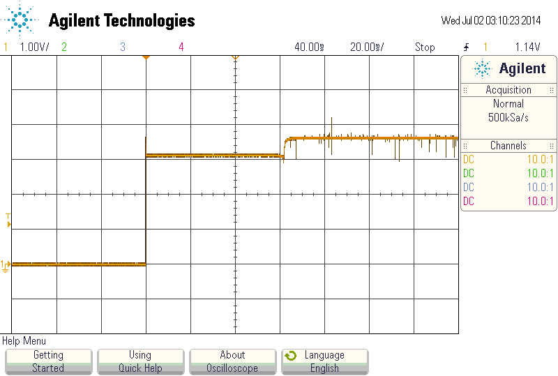

I am using SN74121D timer with its output loaded by SN74LVC2G32DCTR gate. The supply voltage for both ICs is 5 Volts. During a pulse generation, the timer output Q (pin 6) goes high but only to the level of 1.6 Volts. The circuit works as expected but I am wondering why the timer output is not even close to 5 Volt. The datasheet for SN74121D is very old and does not contain any example circuits.
I tested another SN74121D timer from a different lot. Even without a load its output goes high only to the level of 1.4 Volts. This is a suspiciously low voltage for a logical high level.
What is wrong?
Thank you.

  • I am attaching the schematic and the recordings of the waveforms that I get.
    Still waiting for a single reply from TI.

  • The output should be greater than 1.6V. It should be about Vcc-1.  The ouput from the LVC part should be greater than 3.2V also.
    I dont see anything wrong on the schematic.  IC1B pin 6 is connectd to somthing right?
    I am not seeing anything right off that would cause the low output. Have you tried another part?

  • Dear Chris, I have solved this problem. I was just typing the description below when your post came.
    There was an RC filter in the Vcc node (100 Ohm, 1 uF) right after the power entry connector.
    My fault - I got too much used to the supply current values of 10 uA or less in modern logic ICs - that I did not pay attention to the power consumption of 74121. It turns out that this prehistoric monster has the Icc rating of up to 40 mA!
    That is enough to cause a voltage drop of 4 Volts across a 100 Ohm resistor in the supply line. And that is what I've been observing.
    Mystery solved. Many thanks to everyone for their attention to this thread.
