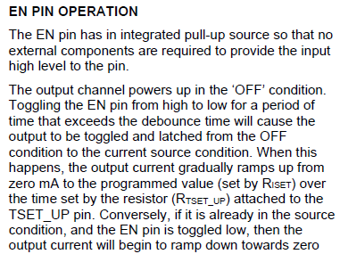

May I have your suggestion on whether SN74LVC1G80-Q1 or any other logic device can help achieve the function below?

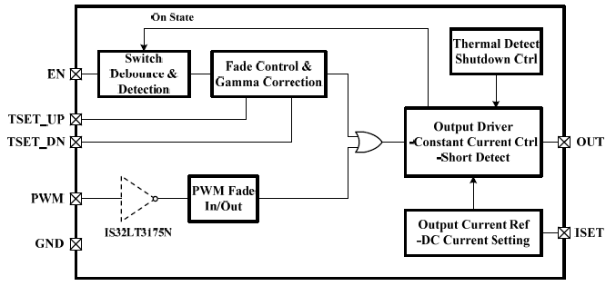

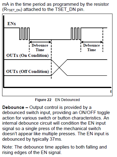

My customer is working on a dome lighting solution. Their application requirement is that the LED can be toggled between IN and OUT condition with momentary contact switch. Their current solution is IS32LT3175, a LED driver with integrated debounce and latch circuit on EN pin to achieve this. We do not have led driver product with same feature, so I'd like to propose replacement solution with a logic device before our LED driver product.
Could you check the following description about competitor's EN pin operation logic and suggests any way to work around? Thanks a lot
