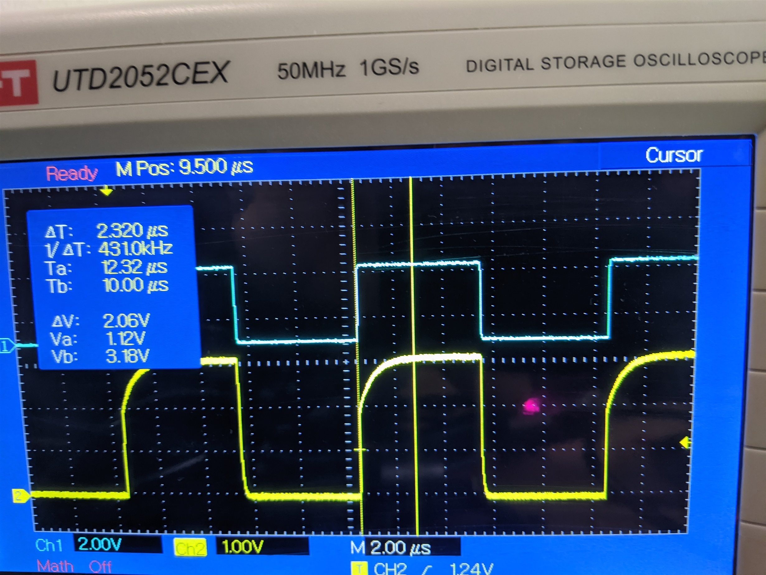

    I did a quick test with the eval board of the TXS0108E. I had my dev board SD Lines hooked up to the dev board, and the dev board to the SD Card. The TXS is using the same level voltage on both sides. I know that if the connection Dev Board <=>SD Card is done directly, it works. If done thru the TCS device, it fails.
    What I proceeded to do was start connecting some wires directly to the MCU and leaving some on the TXS, to try to determine which line was the one that was making the communication fail. After this test, I found that the other lines work, but the CLK line does not (the CS, MISO and MOSI are connected thru the TXS device. If the CLK is connected directly the system works - if connected thru the TXS, it fails).
    I took two different captures of the CLK line explained below:
    1.)  (Blue Line: CLK on the MCU side, captured on the Dev Board pin. Yellow: SD CARD side, captured at the SD Card side. Wires to TXS EVM from Dev board and from SD Card are ~ 12cm total length).
    2.) Blue Line: CLK on the MCU side, captured on the Dev Board pin. Yellow: Right at the output of the TXS0108e dev board pin. Wires to the SD Card disconnected, so no capacitive load on this captures due to wires on the SD side).
    I see both captures very similar. I read the TXS device as internal pull-ups, but I wonder if the system would benefit from pull ups? I sadly don't have any at hand to do a quick test on the EVM.

  • Hey Eduardo,
    That signal doesn't look bad at all so I'm not sure why it would be causing an issue. The slow edge at towards the end of the rising edge is expected with the architecture of the TXS device. The new device will provide a nice clean edge since its better suited for push-pull signals.
    My only thought with the scope shots provided is that the BW is too low (I see 50 MHz). I would expect that wire to add inductance that could cause ringing when the one-shot is firing (they provide a low impedance path to GND increasing di/dt). So its possible you aren't seeing the ringing due to the low bandwidth. I recommend zooming in on one of those rising edges to see if there are any anomalies.
