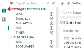

It seems that there are a variety of different pages to set the pins depending on the initial settings in the 'Welcome to SysConfig' page.
For example, If they select something for the 'Software Product' as below,
then they will get the two tabs (Software, Reserved Peripherals) as below,
However if they don't select a 'Software Product' in the 'Welcome to SysConfig' page, they get different tabs, 'Peripherals' and 'Device Settings', as below.
They cannot simultaneously have both set at the same time in the configuration script, so they want to confirm that 1. they are using the tool correctly? (ie. should they select or not select the software product first) 2. is there a difference in the code generated from these two different pages when they do or do not select the software product.
2. As a continuation of the question above, in the scenario that they select a 'Software Product' and they have the two tabs (Software, Reserved Peripherals), if they ADD SPI3 in the 'Software' tab, and they also try to ADD SPI3 in the 'Reserved Peripherals', they get a conflict error. How do they differentiate which tab to ADD the SPI? Can they add it in both or are they limited to one of the tabs?

1.a) Yes, the customer is using the tool correctly. The two options/views they see are the MCU+SDK Software Product (top option) or the raw device pinmux view (bottom option).
1.b) MCU+SDK Software Product provides all functional configuration code for an IP, whereas the raw pinmux only enables auto-generation of the pinmux configuration code. The MCU+ SDK Software Product for a given device will generate the pinmux configuration code by default for the associated peripheral pins.
2) If a peripheral is going to use example SDK code, it should be configured in the Software tab when available. The Reserved Peripherals tab was added to allow users to lock-down specific pins for peripherals that aren't currently supported in the Software tab, without needed to worry about the auto-muxing re-assigning the pin when solving for pinmux options. The conflict error occurs because you are "Reserving" the SPI3 signals in one tab, and then also trying to re-assign them to function in the Software tab. Customer should always add a peripheral in the Software Tab if available.
