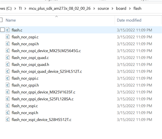

Customer would like to double confirm can MX25V1635F be used on TPR12 EVM.
The driver in demo code shows we use MX25V1635F
/* FLASH Config */
Flash_Config gFlashConfig[CONFIG_FLASH_NUM_INSTANCES] =
.attrs = &gFlashNorQspiAttrs_MX25V1635F,
.fxns = &gFlashNorQspiFxns,
.devDefines = (void *)&gFlashNorQspiDeviceDefines_MX25V1635F,
.object = (void *)&gFlashObject_MX25V1635F,
however, the MFG and Device ID do not match MX25V1635F datasheet.
flash_nor_qspi_device_MX25V1635F.c
The MFG ID and Device ID used in driver are belong to GD25B64C
When Flash Driver Open it will verify MFG ID and Device ID.

Frank,
I use both SDK8.2.0.26 & SDK8.1.1,6.
in SDK 8.2
in SDK8.1
MX25V1635F is the only option in sysconfig tool in both SDK. SDK 8.2 even take out GD25B64C Flash Driver.

Hi Andre,
I found this is a known bug (MCUSDK-3948). The bug will be fixed in the upcoming 8.3 release scheduled for the end of May.
I'm still investigating whether MX25V1635F is tested as part of MCU+SDK, but I guess not since it's not on the EVM. I'll keep you posted on what I find.
Frank
Hi Andre,
I confirmed MX25V1635F is not tested as part of the MCU+SDK release since this flash isn't on the AM273x EVM.
Frank
