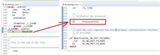

    After each download the bootloader F/W to TM4C129,
    It will start from ResetISR, then run "step over" to ProcessorInit, and it will run to an unknown place,
    And will not move to line 263 ( if $$defined(BL_HW_INIT_FN_HOOK)) .
    Ray Yang
  • Hello Ray,
    That is expected because ProcessorInit is copying the code into SRAM and then executing within SRAM. Therefore the IDE does not have the symbols to debug further. It is possible to load these but I don't think we need to go to that step yet.

  • Also, I have tried to set breakpoints to debug before,
    It seems that there is no response, is this because the code is running in SRAM?
    Ray Yang
  • Hi Ray,
      After you loaded the application firmware and if you want to debug the bootloader then you need to load symbols for the bootloader program.
