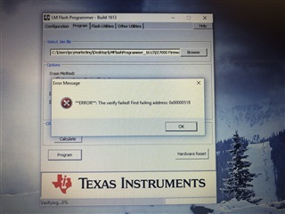

Immediately after entering the verification process, [** ERROR **: The verify failed! The First failing address: 0x00000518] was displayed and an error occurred.
When I clicked "OK", [Expected: 0xC2 Read: 0xFF] was displayed.

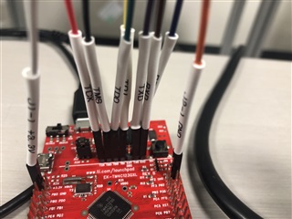

The figure below shows the pin assignments that connect the EK-TM4C123GXL to an external device.
The Configuration tab of "LM Flash Programmer --Build 1613" is as shown in the photo.
The Program tab is as follows.
Is there any possible cause and remedy for this error?

      - Can you do an unlock operation for the target MCU. Go to 'Other Utilities' tab in LM flash program and select 'Unlock'. Follow the instructions to unlock the target device. Can you successfully unlock the device? After you unlock, can you reprogram the failing device again? Will you get the verification error again?
    - In the 'Program' tab, can you un-check the 'Verify after program'? It is not that we want to ignore the issue. I just want to see if other issues will come up without the verify step? Suppose it finishes the programming, will the target device run the program successfully?
        ** I tried to unlock the target device. However, another error [** ERROR **: Unable to initialaize target --0!] occurred and the process of the program could not be executed.
        ** Even if I removed [Verify After Program], the process of the program did not complete normally and [Reset MCU After Program] was not executed.

      - Can you carefully go through this app note in section 4.6 that illustrates how to use a EK-TM4C123GXL LaunchPad to debug out another device?   http://www.ti.com/lit/an/spma075/spma075.pdf
      - In the same app note, go to page 27 and follow the steps to troubleshoot JTAG issues.

      - Please show the schematic of your target board? At the same time also please compare your schematic with section 4.1 on the app note. Section 4.1 on the app note has examples on how to design the JTAG connection.

  • Hi Charies-san,
    Yesterday, I referred to App Note 4.6 and changed the wiring, and I was able to execute programming.
    Thank you for your support.
