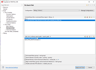

  • Hi, I generate a source code from HALCoGen and add it in my project. I use code from FEE read/write example project and also I stalled in TI_Fee_Init() function (Fapi_doBlankCheck in ti_fee_uil.c:903). Init function takes no parameters, so I expected that it not depends from me. As error occurred I think some troubles happens in my code in initialization and etc. May be this functions from FEE library mush run from RAM, in critical code section or some other stuff?
    It might be due to using of wrong version of the F021_API library.
    We should configure "F021_API_CortexR4_LE_L2FMC.lib"
    Jagadish.
