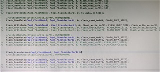

When using the F021 flash API, BANK7 for on-chip flash can only be erased/read/written, but BANK0 and Bank1 cannot be read using the same API. Accessing its address directly jumps to the underlying flash read error. Why is this?

Read and write in main function is as follows:
Below is the implementation of read function:
The following is where bank and sector point to:
Accessing its address directly jumps to the underlying flash read error:(Read operation can return successful if execute read only)
