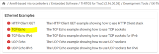

      Do you have the same problem if you run only the non-ip6 example. See below highlighted example. I want to know if you see any difference in your running.

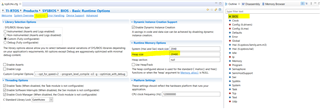

     Can you also increase the heap size from whatever the value you have currently. Perhaps double what you have right now and see if that makes a difference.

    I increased heap size to 32600 and I still had the same error. I also increased SWI and HWI stack size to 8192, still same error. I also increased default stack size for main network task and all NDK low, normal and high priority tasks to 4096 and still got the same error.

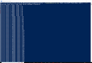

    Also, just to let you know, the way I run the demo is I just load the firmware then run, but I don't send any tcp packets. For the normal tcpecho, it works fine. the MCU is just listening and waiting and never aborts. All my ipv4 TCP applications work fine and they're all based on this normal tcpecho demo. I assume it should work the same way with the ipv6 demo, that is even if I don't send packets, it shouldn't abort right?
    Can you try sending some packets to the server? Does that also abort after sometime with the bus fault?
