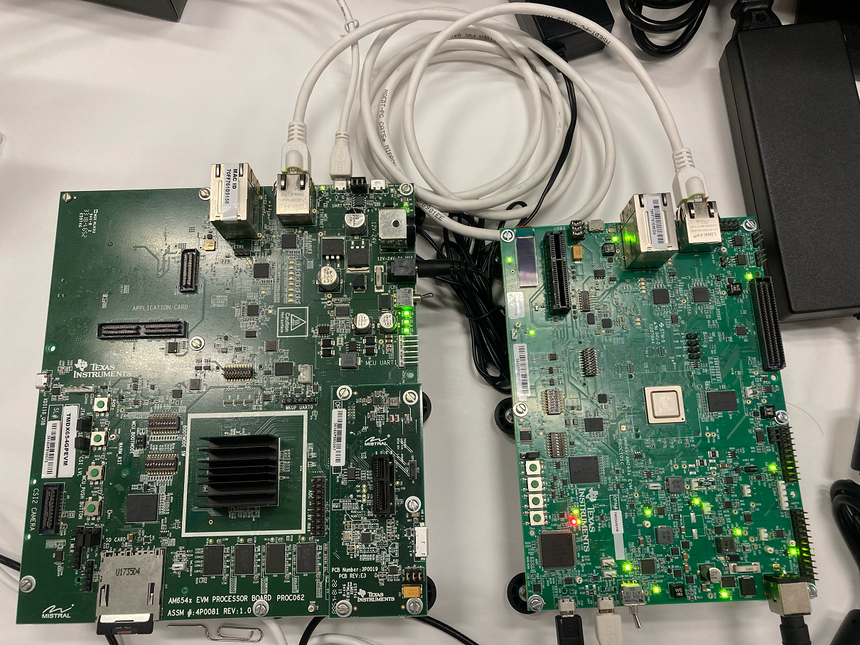

Our customer sees the "Enet CPSW TimeSync PTP Demo" fail with TMDS243EVM. Note that Linux on the TMDX654GPEVM was used for the master clock instead of a Linux PC.
Enet_validateIoctl: Malformed IOCTL cmd 0x01000304 prms 7011F664 inArgs 7011F658 / 8 outArg 00000000 / 0
Assertion @ Line: 1486 in c:/ti/mcu_plus_sdk_am243x_08_06_00_43/source/networking/enet/core/src/core/enet.c: status == ENET_SOK
I have reproduced the issue. Note that TMDS64EVM was used instead of TMDS243EVM.
Attached are the message logs for each of TMDX654GPEVM as a PTP broadcaster and TMDS64EVM with the demo.

root@am65xx-evm:~# sudo ptp4l -i eth0 -m -2 -P -l 6 -q -f $HOME/ptp_config.cfg
ptp4l[237.143]: selected /dev/ptp1 as PTP clock
ptp4l[237.581]: port 1 (eth0): INITIALIZING to LISTENING on INIT_COMPLETE
ptp4l[237.582]: port 0 (/var/run/ptp4l): INITIALIZING to LISTENING on INIT_COMPLETE
ptp4l[237.582]: port 1: link down
ptp4l[237.582]: port 1 (eth0): LISTENING to FAULTY on FAULT_DETECTED (FT_UNSPECIFIED)
ptp4l[237.916]: selected best master clock f4844c.fffe.ed2cf2
ptp4l[237.916]: selected local clock f4844c.fffe.ed2cf2 as best master
[ 296.506855] am65-cpsw-nuss 46000000.ethernet eth0: Link is Up - 1Gbps/Full - flow control off
[ 296.515469] IPv6: ADDRCONF(NETDEV_CHANGE): eth0: link becomes ready
ptp4l[296.428]: port 1: link up
ptp4l[296.714]: port 1 (eth0): FAULTY to LISTENING on INIT_COMPLETE
ptp4l[300.006]: port 1: announce timeout
ptp4l[300.007]: port 1 (eth0): LISTENING to MASTER on ANNOUNCE_RECEIPT_TIMEOUT_EXPIRES
ptp4l[300.007]: selected best master clock f4844c.fffe.ed2cf2
ptp4l[300.007]: selected local clock f4844c.fffe.ed2cf2 as best master
ptp4l[300.007]: port 1: assuming the grand master role
L2 Multi-channel Test
Init all peripheral clocks
Enabling clocks!
Create RX tasks
cpsw-3g: Create RX task
Open all peripherals
cpsw-3g: Open enet
EnetAppUtils_reduceCoreMacAllocation: Reduced Mac Address Allocation for CoreId:1 From 4 To 2
Init all configs
cpsw-3g: init config
Mdio_open: MDIO Manual_Mode enabled
cpsw-3g: Open port 1
EnetPhy_bindDriver: PHY 0: OUI:080028 Model:23 Ver:01 <-> 'dp83867' : OK
PHY 0 is alive
Attach core id 1 on all peripherals
cpsw-3g: Attach core
cpsw-3g: Open DMA
initQs() freePktInfoQ initialized with 16 pkts
cpsw-3g: Waiting for link up...
Cpsw_handleLinkUp: Port 1: Link up: 1-Gbps Full-Duplex
MAC Port 1: link up
cpsw-3g: MAC port addr: 34:08:e1:80:b5:c0
TimeSync PTP enabled
Enet Multi-channel Menu:
'c' - GetCurrentTime
't' - Toggle Printing timestamps
's' - Print statistics
'r' - Reset statistics
'm' - Show allocated MAC addresses
'p' - Enable Policer for rate limiting
'x' - Stop the test
Enet_validateIoctl: Malformed IOCTL cmd 0x01000304 prms 7011FB64 inArgs 7011FB58 / 8 outArg 00000000 / 0
Assertion @ Line: 1486 in /nightlybuilds/mcupsdk_internal/jenkins/mcu_plus_sdk_am243x_08_06_00_45/source/networking/enet/core/src/core/enet.c: status == ENET_SOK
Could you tell me how to fix the issue?
