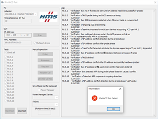

I built the demo below and checked its operation.
"ethernetip_adapter_generic_device_mii_demo_am243x-lp_r5fss0-0_freertos_ti-arm-clang"
We checked with version 09.00.00.03 of INDUSTRIAL-COMMUNICATIONS-SDK-AM243X.
When running the ACD Automated Test, an error occurred in the following test.
P8.5.6     Verification that multi port devices restart the ACD process on link up
P8.5.6 ***> Did not receive valid ARP in 10 seconds
If you start with LAN connected to two Ethernet ports, an error will occur indicating that ARP packets are not being sent correctly.
An error occurs if the link with one of the connected managed switches is fast.
