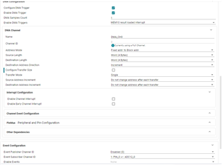

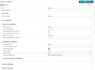

Could you post a screenshot of the sysconfig settings you are using for the DMA and for the ADC? I would like to compare them to the settings I have used in my own similar implementation.
Absolutely, I've posted the full ADC1 sysconfig in the three screenshots below.
Event channel 12 is the channel published to by the 500kHz signal input.

Can you try changing your DMA address mode to "Fixed addr. to Block addr."?
I tried implementing this on my own and was able to get it working, so it is certainly possible. There are some other differences between ours but I believe the above is the reason you are having trouble. You may also want to change your transfer mode to single, as repeat single should cause multiple single conversions to occur after a single trigger. I also kept destination address increment set to unchanged.

Unfortunately that hasn't worked for me either, I'm still getting only a single value added to the array per burst.
Regarding the transfer mode, my understanding was that 'Repeat Single' simply left the DMA channel enabled but awaiting further triggers, is this not right?

Ah, I think I know why your ADC is taking more than one sample.
If you left the "Trigger mode" default in ADC repeat mode it will continue to take samples continuously rather than waiting for the GPIO event to take each sample.
This was discussed on the "original question" linked to this one, the Trigger mode sets the "TRIG" bit in the MEMCTL register, with 1 meaning a trigger is required for each sample and 0 (the default) only requiring the initial trigger)
I see what you mean about the trigger mode in optional configuration. However if I do leave all other settings the same, then change the trigger mode to "Valid trigger will step to next...", then I am sampling correctly on the falling edge of the 500kHz square wave rather than continuously at maximum speed. However, using the other setting for trigger mode, I still fill my buffer with data, it just fills as fast as the ADC can perform conversions, rather than on each falling edge. This leads me to believe that the problem is in your DMA configuration.
