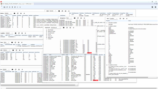

Below a screenshot of the ROV:
There are not memory overruns within the tasks, the only red one is just closing and in the moment a task exits/deletes, ROV always shows PeakSize = TaskSize. There are no overruns in mailboxes (the overrun itself would not harm but it could show that something is going wrong with a task execution), no Semaphores pending unexpectedly.

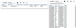

There is plenty of heap memory, the only strange thing is the orphan heap with ID 12 which requested 0 bytes and it shown in overrun state. But as the system clock counter is low, this does not seem to be related to the exception to me.
All Hwi interrups result despatched and - not visible here - also on Swi/clock side there is nothing pending.
NDK is fine as well in terms of memory and working sockets.
