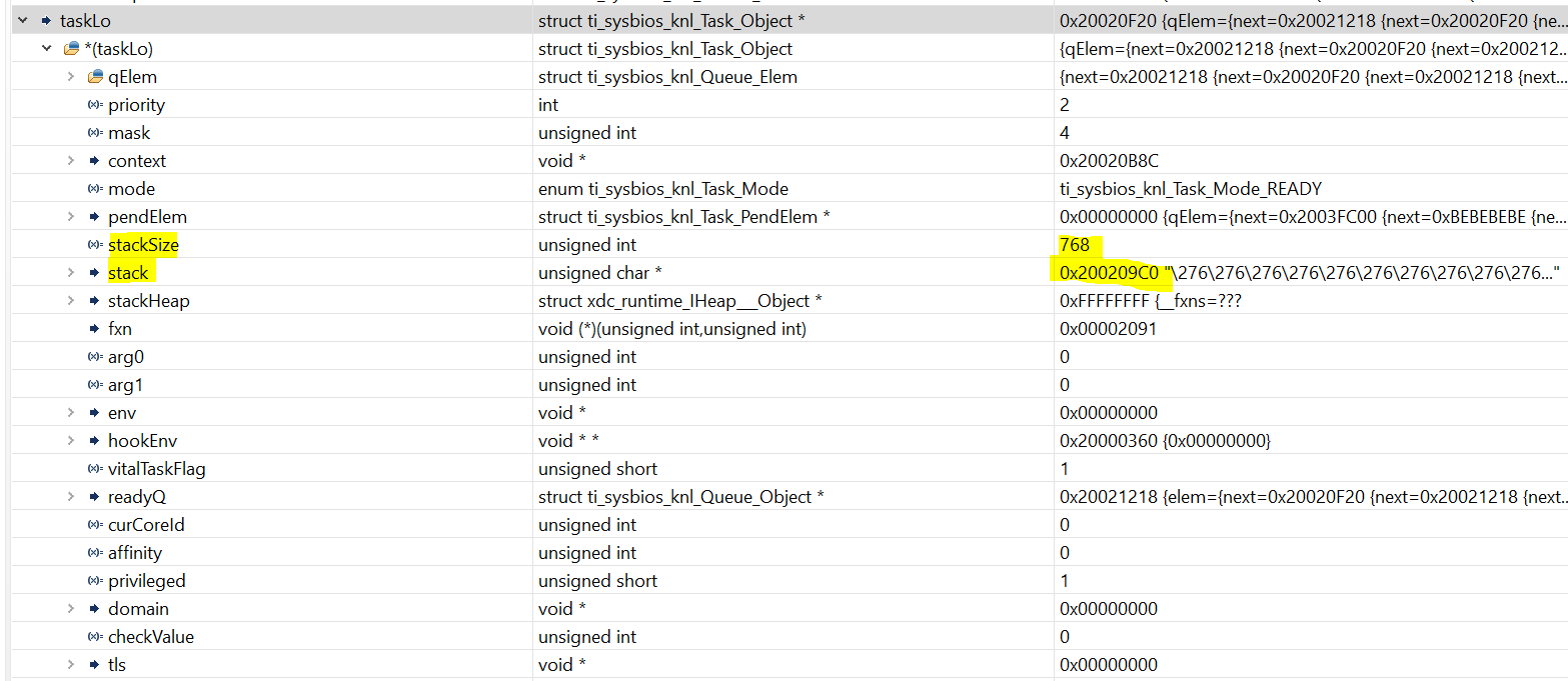

    Thanks for ruling out the application usage of a Clock_Struct. We're trying to reproduce the scenario where the Task_sleep's Clock_Struct is not removed in the Task_destruct (actually Task_Instance_finalize).
    The information you gave us did not include the task stacks. One way to get that is by looking at the Task_Handle (since you are not using CCS....otherwise the easiest way is to use ROV). For example, taskHi is a Task_Handle in this application. When I show in the expression window in CCS, you can see the stack and size.
    Can you please confirm that the corrupted Clock_Object is on the stack of the task that had its priority set to -1, destructed and then constructed. This helps rule out other corruption.
    Regarding the task that was destructed and then constructed again, was the stack provided in the Task_Params or did you let the Task_construct API allocate the stack (by have Task_Param's stack be NULL)? If you provided the stack, can you confirm the stacksize parameter is correct (e.g. it is the size of the stack buffer you provided). I expect it is correct, but it should be an easy thing to confirm.
    Meanwhile, we will continue to see how the Clock_Object used by the Task_sleep could be left on the Clock's queue. The main kernel scheduler developer will be back in the office tomorrow and hopefully he'll spot something.
    Todd
  • Rei,
    Also in the above picture is the task mode (Task_Mode_Ready) two lines before stackSize. Can you get us that value also? We remove the Clock Object when the mode is Task_Mode_READY or Task_Mode_BLOCKED. Something else would explain the issue, and we could focus our search.
    Todd
