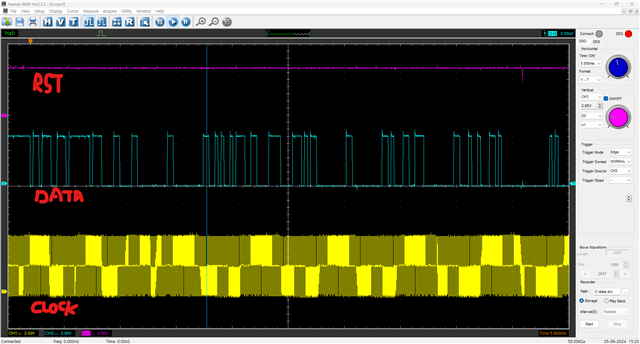

Hi Helic
When I tested your project I got the following result:
What we want to check is that tx data is transmitted at a baud rate of 115200 when the clock is 4~5MHz.
<Check please Test result Photo>
thanks
Hi Helic
After connecting an slave in ISO7816 SmartCard mode, the actual data and the data received in the RX buffer are different.
Actual data: 3b 7f 18 00 00 4a ...
Buffer: 48 c0 00 00 00 ...
Could you please review the attached source code and point out any errors?
Thank you.
