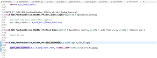

I'm having some troubles with the configuration of the strobe latch with EQEP_setLatchMode.
EQEP_getStrobePositionLatch returns new values on both rising and falling edges for both clock-wise and counter clock-wise
1. One of my modules fully configures the EQEP module.
2. During run time - I want to use EQEP_setLatchMode to control the strobe latch mode.
3. No matter which flag I pass - there is no change.
