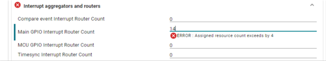

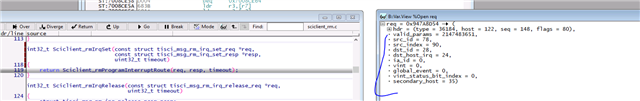

I'm using AM243x. I want to trigger a BCDMA channel transfer using a GPIO interrupt using L2G.
I have previously asked the question and got this answer:
https://e2e.ti.com/support/processors-group/processors/f/processors-forum/1261456/am6442-compare-router-to-trigger-bcdma/4785658?tisearch=e2e-sitesearch&keymatch=%2520user%253A563969#4785658
Now that I'm trying to configure it by sending the SCIclient message, it returns an unsuccessful. Previously I was told that since the GPIOMUX_out_16 is not routed, so I considered it can be the reason that it fails. I was told I should add it in the sciclient_defaultBoardcfg_rm.c as follows:
When I try to add it in boardcfg Sysconfig tool, it gives an error that it exceeds the number of resources as here:
these are the configurations for the message that I'm sending to allocate a GPIO interrupt to trigger a bcdma_blkcpy channel. by mapping the interrupt to GPIOMUX_OUTP_16 mapped to L2G_24. the fields of the sciclient message to configure the interrupt is as in the second following picture.

    I have already read the FAQ and my question is not addressed there. Please reread my question. My problem is configuring the boardcfg and as I showed you it gives me an error that is impossible to have more than 16 gpiomux, which was not discussed.
    This means that syconfig gives me an error as if there are not more than 16 gpiomux existing to be allocated. what I need is the 17th and 18th gpiomuxes but it's impossible to add them neither for am64x nor for am243x.
    however, based on the figures used in the FAQ you mentioned (following image):
    it seems that they have been able to generate 17 gpiomux (0 to 16) which is impossible to make it in syscfg. I have also added our syscfg file, where we are not able to add more gpiomux. Would appreciate it if you could try this file and check why we are not able to do so.

  • Hi, Tushar:
    please take a look at ResDependencies.Json,
    the sysconfig tool for boradconfiguration only allows 16  resources assigned to AM64X_DEV_MAIN_GPIOMUX_INTROUTER0
    and 12 resources assign to ICSSG_0,  see "the image cut".
    I can change to 17, right? or add another entry.   it won't violate the rule, at sysfw_boardcfg_rules.json,   in rules, I saw you are allowed to allocate up to 54 resources to  AM64X_DEV_MAIN_GPIOMUX_INTROUTER0
    Thanks.

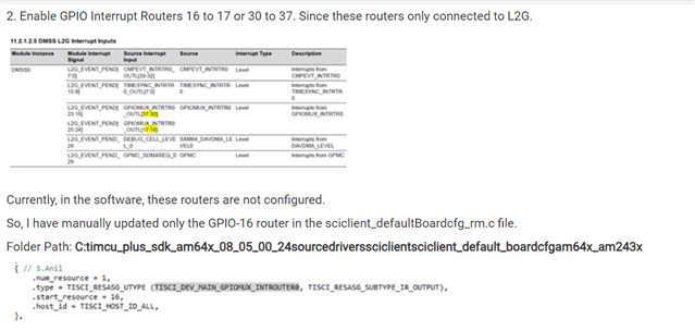

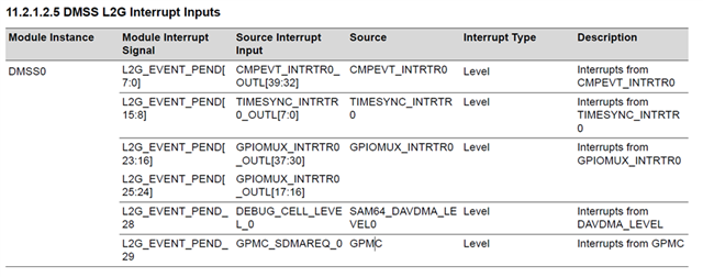

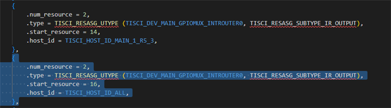

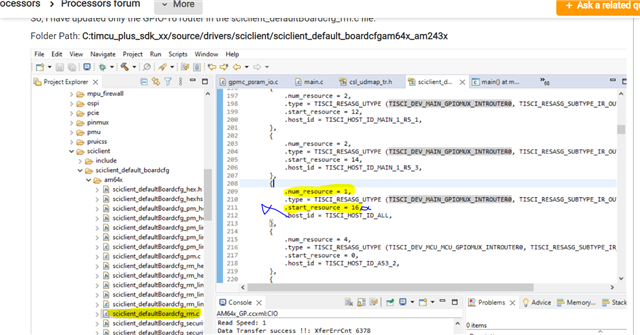

  • Hello Boshra,
    I can check that the GPIOMUX_INTROUT_16 is not configurable through the resource partitioning tool.
    Can you please directly update the entry inside sciclient_defaultBoardCfg_rm.c file located at ${MCU+SDK}/source/drivers/sciclient/scilcient_default_boardcfg/am64x_am243x and update the result?
    Please refer the below image.
    After adding the above piece of code, do the following.
    • Rebuild the sysfw blob.
    • Rebuild the SBL examples.
    • Re-flash the SBL binary.
    Run the command from root of ${MCU+SDK} to create sysfw blob and SBL binary.
    gmake -s -C tools/sysfw/boardcfg/
    gmake -s sbl clean
    gmake -s sbl
    After performing the above steps, you will now be able to run the example. Please let us know if the above solution works.
    Tushar

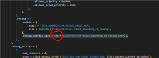

  • Hi Tushar:
    In addition to your post.
    we need also to increase the entries_size.
    original entry size +1
    Am I right?
  • Hi Jun,
    Am I right?
    Yes, correct. Please update the entry size by +1.
    Tushar
  • Hi Tushar,
    I have modified the file and did all the steps after to regenerate the boardcfg based on the new configuration and also rebuild the sciclient_ccs_init, etc.
    However, the example provided to me still does not work! so even with the new boardcfg, the example does not work. and Sciclient_rmIrqProgramRoute returns an error status.
    Can you please take the project folder that was given to me and verify if it works on your side? Can you verify that the sciclient Sciclient_rmIrqProgramRoute not returning an error? because on my side even with modified boardcfg it does not work.

  • You can find these lines that are added in the following attached code:
    .num_resource = 2,
    .type = TISCI_RESASG_UTYPE (TISCI_DEV_MAIN_GPIOMUX_INTROUTER0, TISCI_RESASG_SUBTYPE_IR_OUTPUT),
    .start_resource = 16,
    .host_id = TISCI_HOST_ID_ALL,

  • our problem is resolved. it was an internal problem, our environment has been changed...
    Boshra
  • Hi Boshra,
    Thanks for the confirmation.
    Closing the thread.
    Tushar
